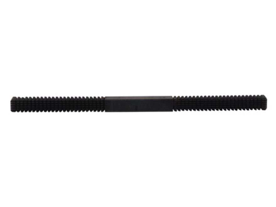

If you want to save the threads, use one of these thread file tools. I keep a metric and an SAE version in my toolbox, they work great.
https://www.lowes.com/pd/KD-Tools-Me...zes/1000972818
How do you use that? Might be a dumb question, but how does it restore the threads?
Each side of the file has a different pitch or threads per inch. You pick the one that fits the thread pitch that you are working on. The file will guide in the good threads and overlap to the bad threads. It will cut the cross threaded bad threads back to match the original thread pitch. File around the OD of the bolt or fitting until it cleans up.
Ya beat me to it! That file is a "Must Have' in your tool box.
Man I wish I knew about that a few days before. I might still go buy it and try it out.
