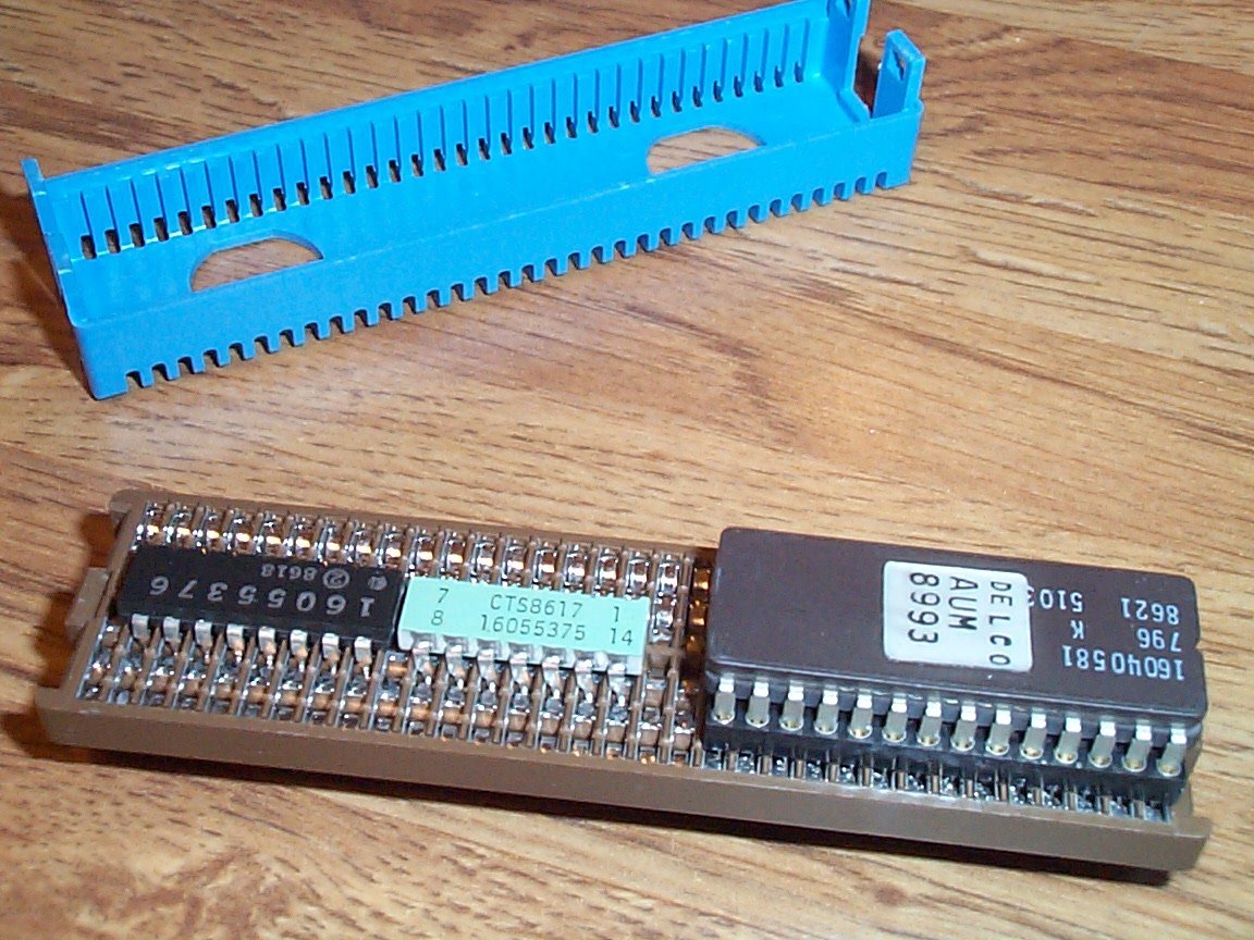

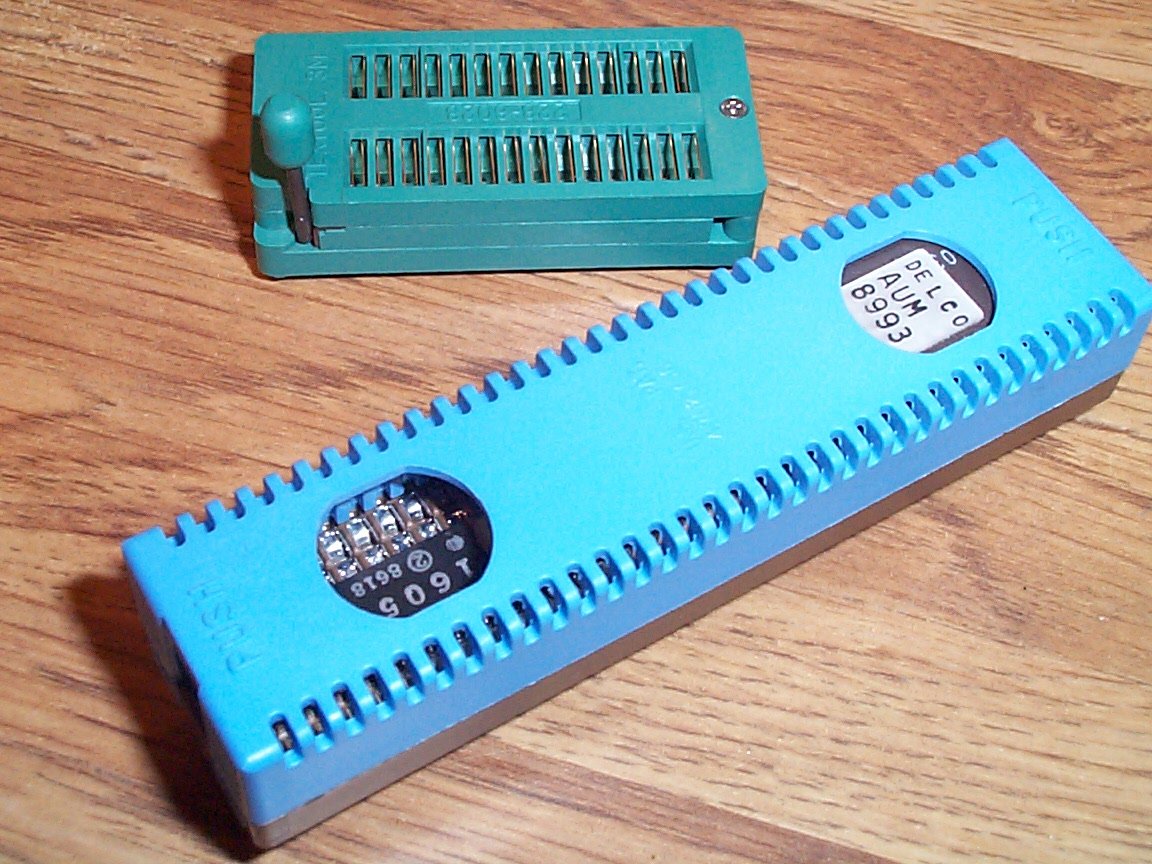

Be careful about the terminology. A CALPAK is the complete calibration unit, whereas the PROM is only the DIP memory package within the CALPAK.
CALPAK (a.k.a. MEMCAL):
PROM (pictured in add-on socket):

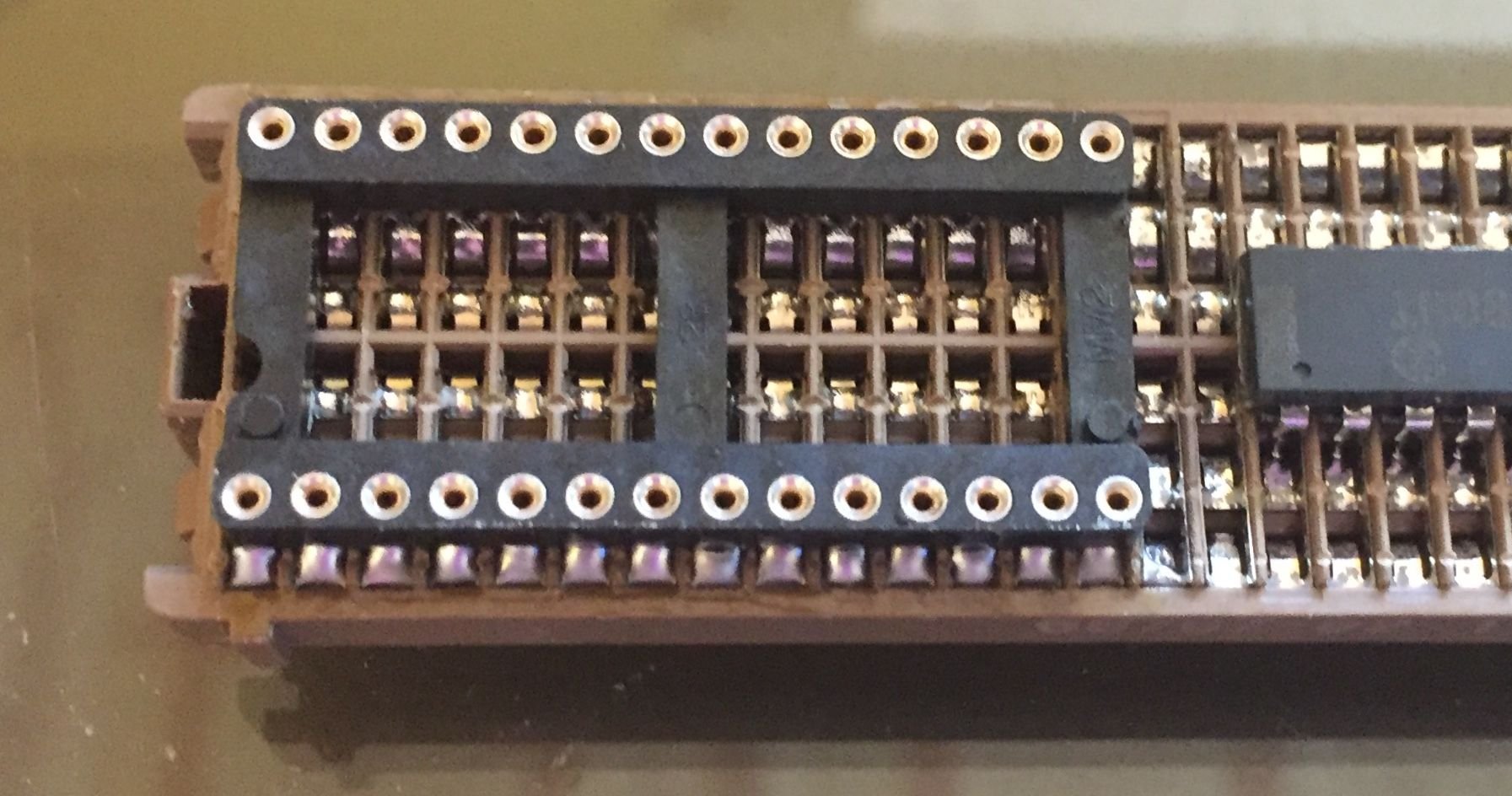

i unsolder the stock chip and solder in a adapter then use a newer style flash based chip.
