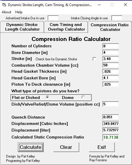

Using a stock flat top piston shortblock for inputs along with an .026" head gasket and the 58 cc heads gets you about a 10.7:1 static compression ratio.
While plenty of SBC's have been built with that SCR, it takes some extended cam timing to make it work. That cam may not fit in with some of what you're building the car around. Either of the two cams listed will be too short and drive the compression pressure up to a point where it may unworkable.
A few assumptions in the absence of real measurements. The piston below deck at .025" is one. You can check that yourself and it's easy if you have a dial indicator and feeler gauges. Lay a straight edge across the cylinder with the piston parked at TDC. The thickest feeler gauge that fits between the straight edge and the piston top is your piston down the hole value. It's a little trickier without a dial indicator but with patience you could zero in on the number. Getting TDC just right is the hard part. The .026 gasket could be swapped for anything really but you mention quench and it has significance as best practices tend to achieve .040". The .026 gasket creates .050 so you're getting away for that already but at a possible 10.7:1, any tighter and your goals for the car are getting further away.
The short duration cams listed I think will drive up the dynamic compression excessively. Even a cam with 224@.050 on a 110 LSA is netting over 8.5:1 DCR. You may be able to get away with it with some good tuning and the aluminium heads extend the workable compression ratio a certain amount but the small 58cc chamber may make life difficult.
