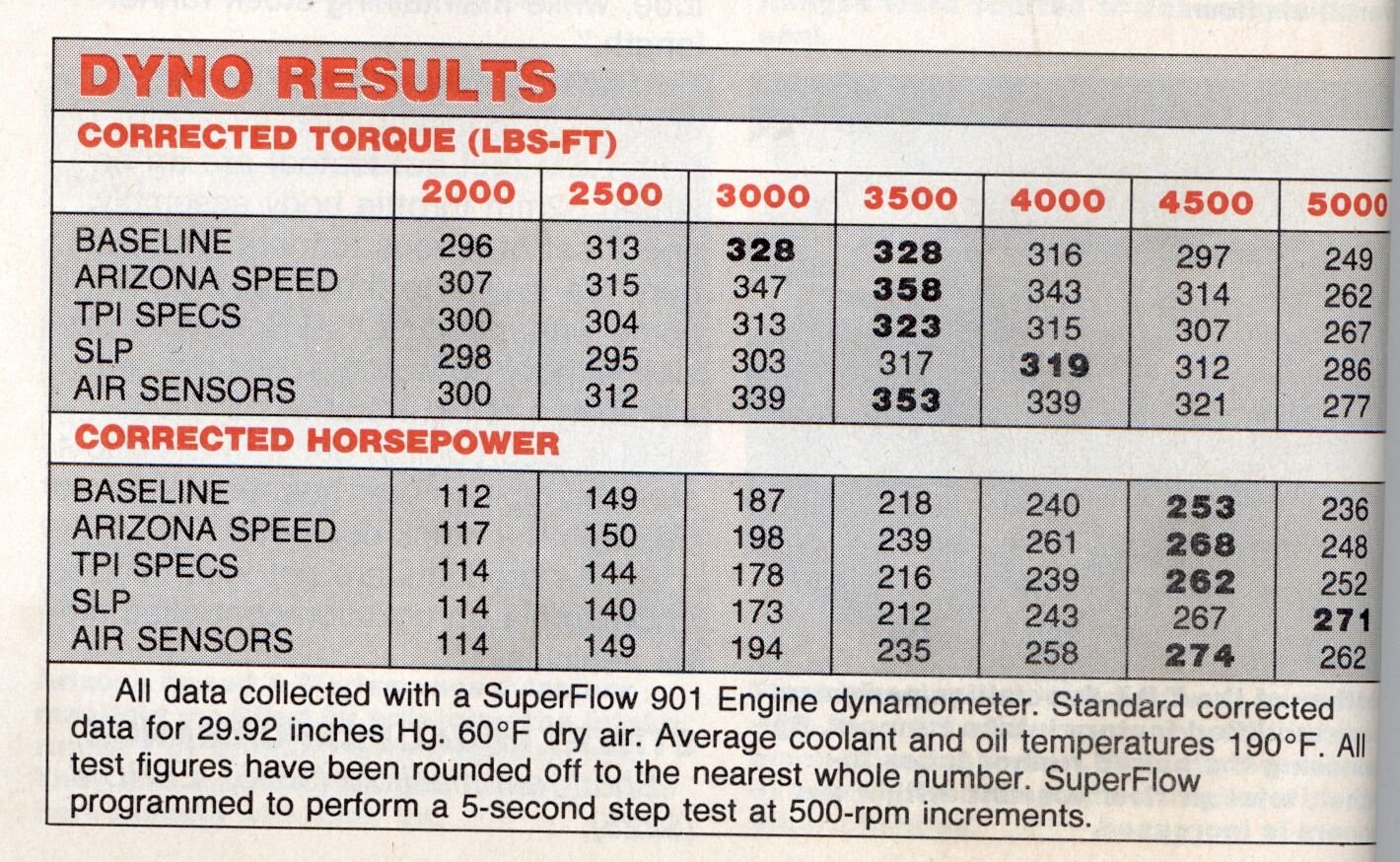

OK I compared SLP runners chart to Car Crafts TPI shoot out and I feel the Car Craft's testing to be the hands down honest reporting.
The SLP do not even bet the stock runners until 5000RPMs and ONLY in HP, they run behind or lower by far in torque.
I will stick to the stock runners and sell off these runners.
Rich
AZ Speed was THE place for TPI Parts back in the day. The results shown, prove this.
I do like the look of the SLP Runners though. Perhaps more than others.
The JL-1/SuperRam is the most aggressive of all though. That's what I ended up with back in the 90s.

The thing that blows my mind is how much it costed even then for so LITTLE improvement.
I kind of think that is true for almost all hot rod hop ups.
Rich
PS They managed to GAIN 274-253=OMG 21 Horses….for only $2495.00 that is $119.00 PER Horse, and 353-328=25 FtLb of torque.
I gained 50 horses by just buying a 03 Crown Vic to replace my dead 2000 Mercury…and it only cost me $1000.00 and I got the whole car thrown in with the deal. Granted I only went from 200HP to 250...
Rich
I have this article from May 1989 Car Craft.
The baseline was a totally stock TPI unit with a stock chip set at 6 degrees
The AS&M set up is a hand ported stock base with their AS&M runners and ported plenum using a stock chip at 6 degrees
SLP brought a prototype intake called the ShortRam that never made it to production. It looks VERY much like the Holley StealthRam and they brought a custom chip to use for testing.
TPiS used the "Big Mouth" intake, their Semi-Siamesed runners, an air foil, and a modified MAF sensor, stock chip,,, set at 6 degrees.
Air Sensors, FIRST used it's single mono blade throttle body,,, which should flow around 800 cfm,, it's own fueling electronics, and 4" MAF sensor with a mecahnical advanced distributor set at 6 degrees.
This was basically a stock L98 with the old Edelbrock 1.5" / 1.625" headers running through an F-body dual cat exhaust system. I doubt very seriously any of the systems were nuts on tuned but I doubt they were way off either. The FIRST unit might have had an advantage of user tuning,,,, that might be good,,, it might be bad. It definitely had an advantage with a larger MAF sensor and throttle body than the rest,,, but it's not like this stock engine actually needed it.
So you can't compare the SLP runners you have to the SLP intake in that chart. If you're not planning on porting them, they'll only give a few extra HP over the stock units.
Rich
Thanks for posting this chart. I chose my AS&M runners for their "stock look" and it is nice to see they do perform overall the best from the bunch.
Old Apr 18, 2020 | 01:41 PM
Drew's Avatar
iTrader: (58)
Posts: 20,310
Likes: 1,068
From: Salina, KS
Re: TPI SLP RUNNERS, performance tests
There's a reason SLP runners were about $200 new, and the AS&M/TPIS runners were $400.

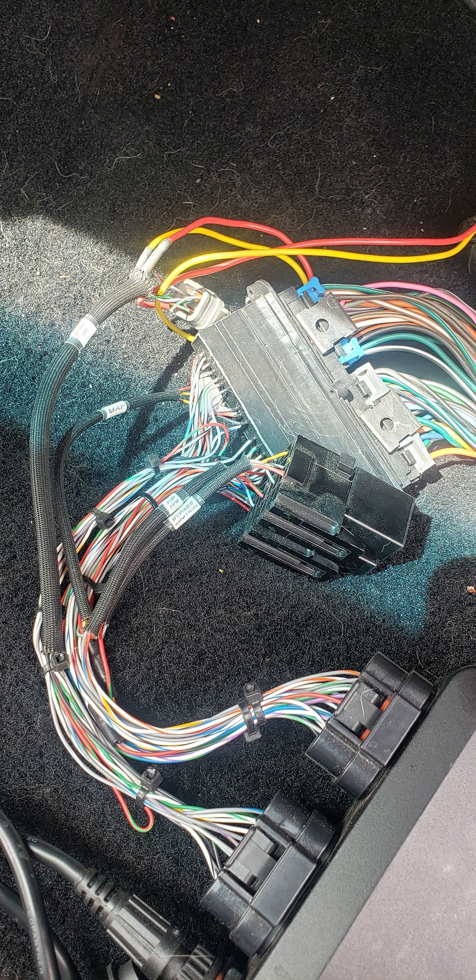

They don't offer a plug-and-play circuit board. The line of wire-in ECU's covers all other situations like the 7165 where the market is small. We have several people that work closely with LINK to produce adapter harnesses for such applications. I am currently running a G4-X Xtreme. I have previously run a G4+ Storm. Both have the same pinout and work with our adaptor harness.
With the adapter harness the only wiring change is to wire in the MAP instead of the MAF (3 wires), and bypass the knock module (2 wires) as the LINK handles the knock sensor directly. No other changes to the 7165 wiring are required.

So you remove the factory ECM, connect your wire harness to where to the factory ECM connectors, and then plug in the LINK to the other end of your wire harness? (and then run 3 other wires for MAP, and Knock)

Correct. You don't need to "run" wires per-se. You just use the wiring that was already going to the MAF and steal 5v from the TPS. The knock wires are both at the knock module - you just merge them.
