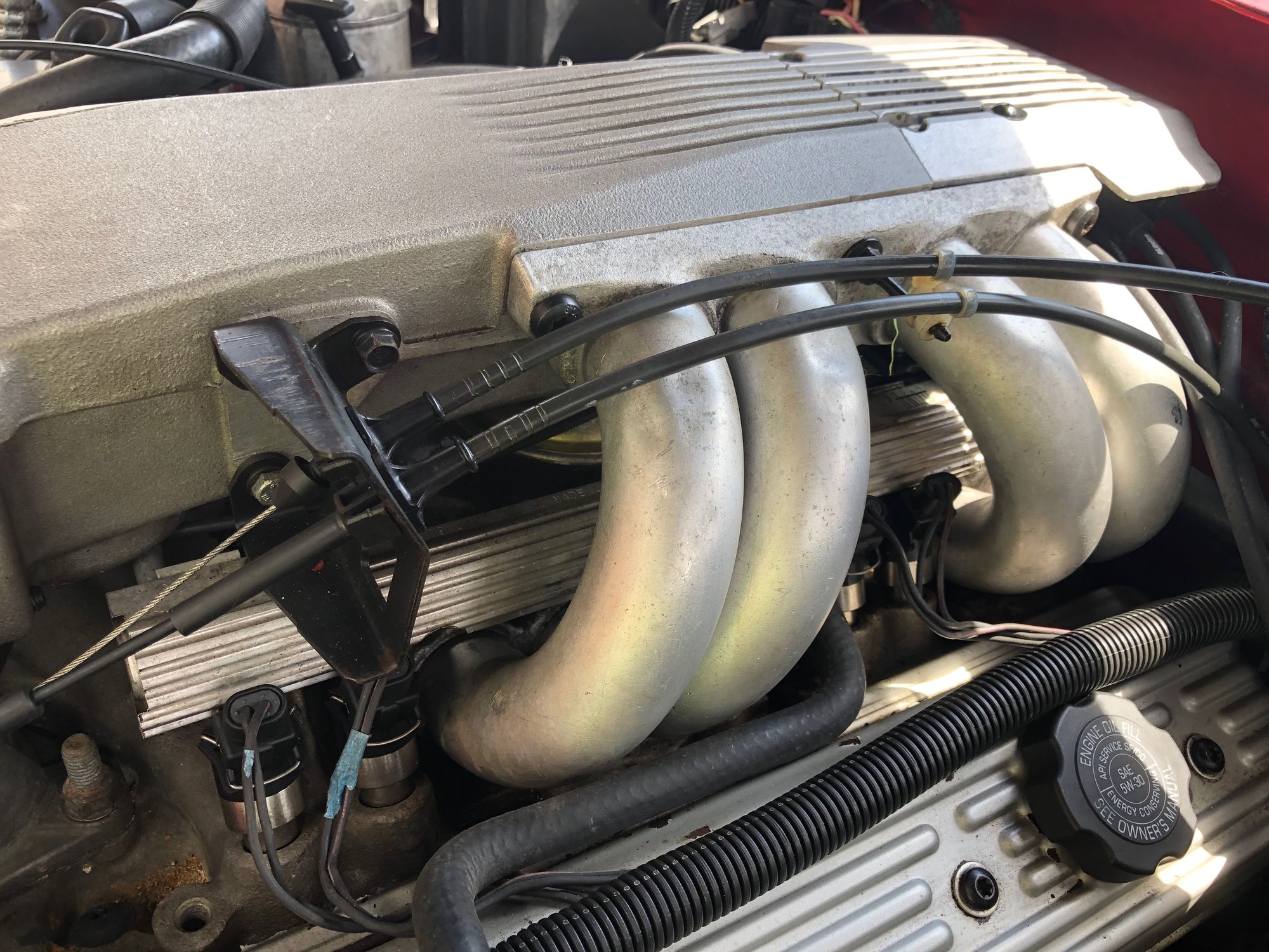

4. Looks like they are not grey injectors they look more black - but they look fresh - see pic.
Thanks.

Any identification numbers on the injectors? They have been replaced but might be 22#hr I’m assuming it’s a 305 and using 19#hr.
Any evidence of fuel in the fuel pressure regulator vacuum line?

You really need live data from the ECU to know what's going on. Otherwise you are just guessing. Those injectors don't appear original so someone has been in there and there's no telling if they made anything better or compounded the situation with incorrect parts, etc.

Those are definitely aftermarket injectors.
