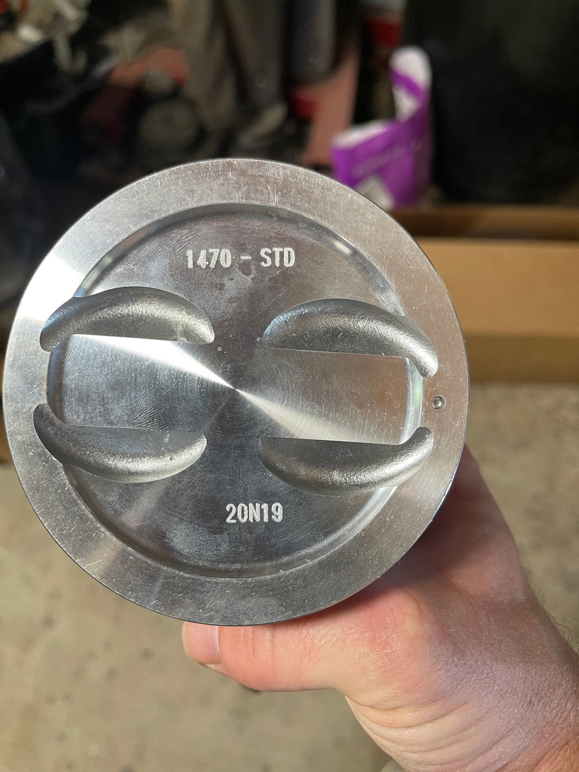

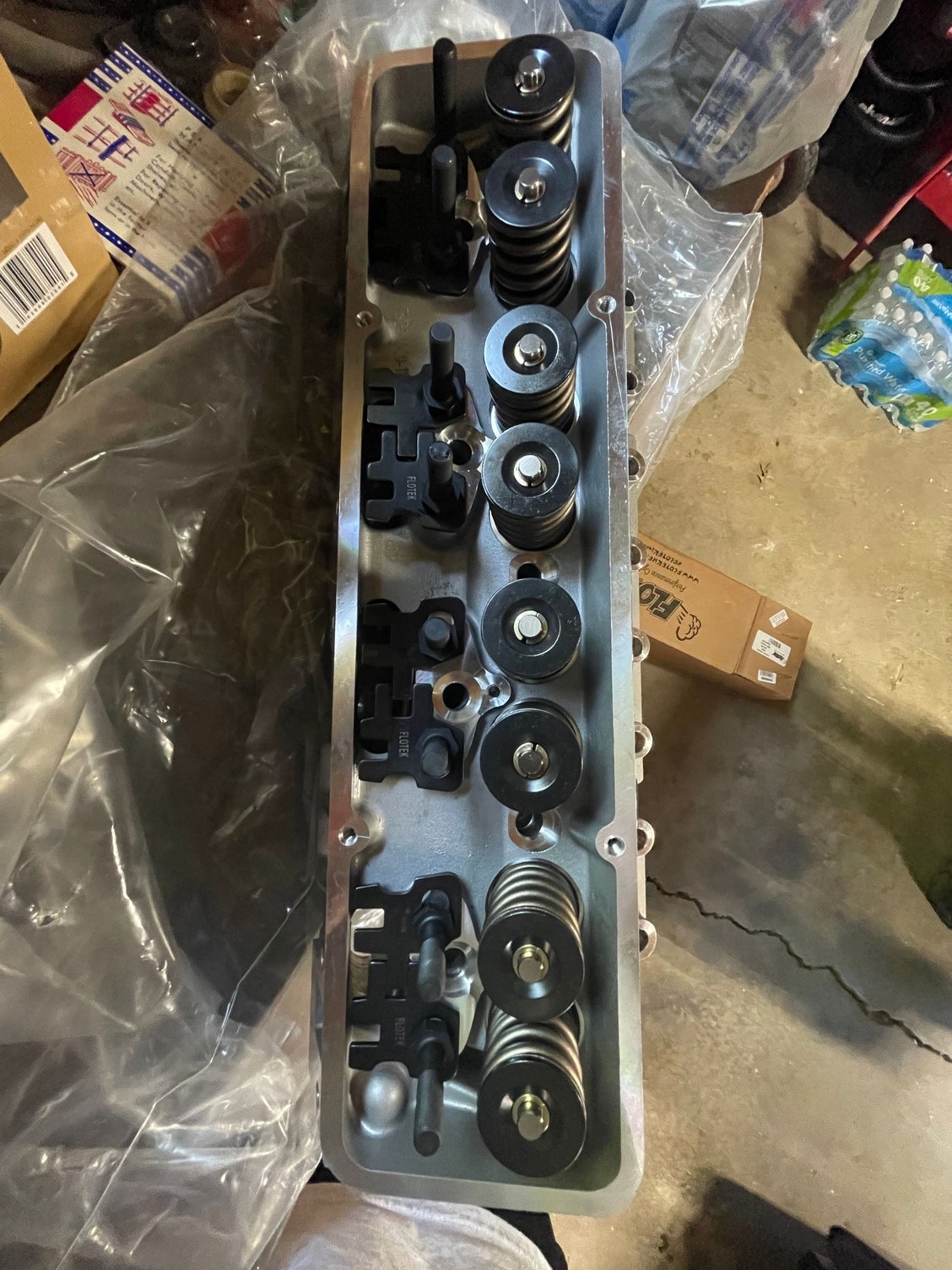

I’m rebuilding my 350 TPI, Its and 89 MAF, I spun 2 main bearings and 2 rod bearings cause my oil pick up fell off. Just looking for some info on what I have and what I bought and what I want to get to complete the rebuild. I have SBC rebuild kit, new crank, connecting rods, pistons, mounted and balanced. I bought new aluminum flotek 102-505 heads, I have a zz4 cam but might look to upgrade. I have American muscle venom 24lb fuel injectors, Edelbrock ceramic coated shorty headers with the air injection, flow master cat back 3” exhaust. I would like to get the First Performance intake but that’s just not in the budget right now so, intake runners and plenum will be stock for the time being. I will need a tune and I know who to go to just wanting some feed back mainly on the injectors heads and cam, I was told I can go up to 650 lift with hydraulic roller. I have pictures attached of my heads and a piston let me know what else you may need. Thanks for any input

I'm not very familiar with those heads but quick research seems to show they're a fair upgrade from stock. Properly set up, those heads and a zz4 cam will make a nice easy driver. The factory intake would be limiting the possible output on that combination, the FIRST is a good choice. As far as the injectors, make sure your tuner has the voltage offsets for them.

I ran those injectors on factory computer no problem with BBK adjustable FPR when I put the zz4 cam in. I had my heads ground and redone to support the cam. These heads were recommended from my shop I took my rotating assembly to, to get balanced. I’m going with Comp pro magnum 1.6 full roller rockers if I keep the zz4 cam but since I’m in a complete rebuild and have the funds I wanting something a little more choppy but not too extreme just not sure what. I’m planning on contacting Tuned Performance for my chip. I’m from Ohio

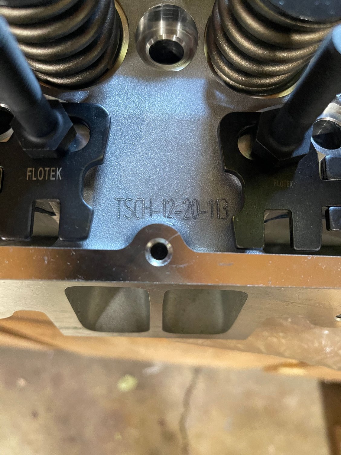

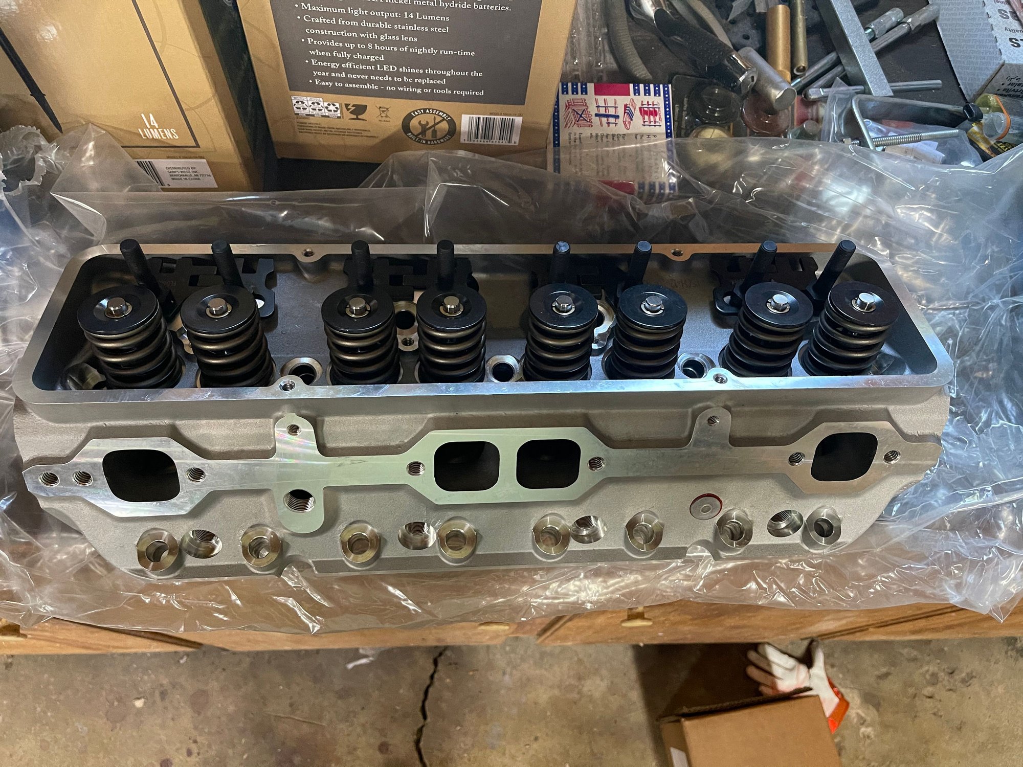

What heads are yours?
Old Jul 25, 2021 | 04:55 PM
Reggiedaman05's Avatar
Joined: Jun 2021
Posts: 8
From: Wapakoneta Ohio
Car: 89 GTA
Re: My Engine Rebuild
The 180cc heads
