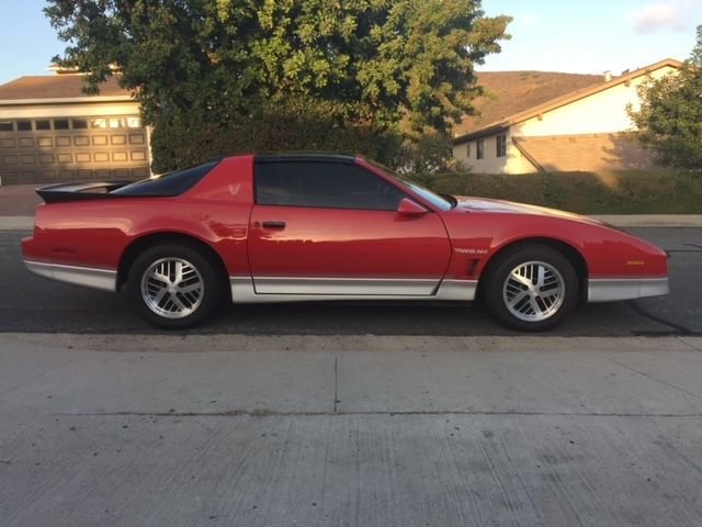

This is the car that I mentioned in the previous message for the new MAF.

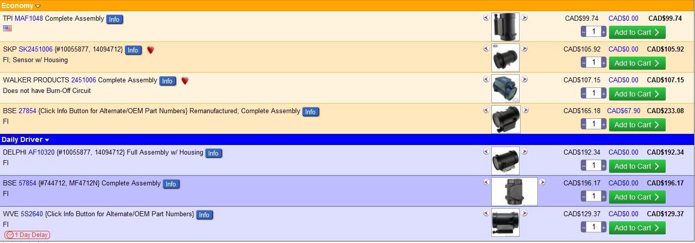

I have a Standard Motor MF4712 on my car that is a reman Bosch. It works fine for me. Are any of the remans Bosch?
I have a somewhat interesting (to me) story about my reman Bosch maf. My friend bought it in 2003 or so for his 1985 305 TPI. Back then you couldn't go on the internet and find the right part in seconds. It wasn't the right maf. He couldn't return it so he put it back in the box and it sat in his dads garage from 2003 until 2012 when I bought his Camaro off him. I had no need for the maf but I took all the parts he had laying around. I converted that car to speed density and never used the maf. I tried for years to sell the maf on local classifieds with no luck. I only asked like $40 for it. In 2020 I bought a 1987 Camaro 305 TPI and it wasn't running well. I took the maf off and it was de-screened and the heat sinks were cut off. That's when I remembered I had the "new" maf. I put it on and all is good. That maf was sitting around in a box for 17 years and finally got it's day in the sun.
I just looked on rockauto and the BSE 57854 says is new and the picture shows Bosch housing. The BSE 27854 says reman and shows Bosch housing.
