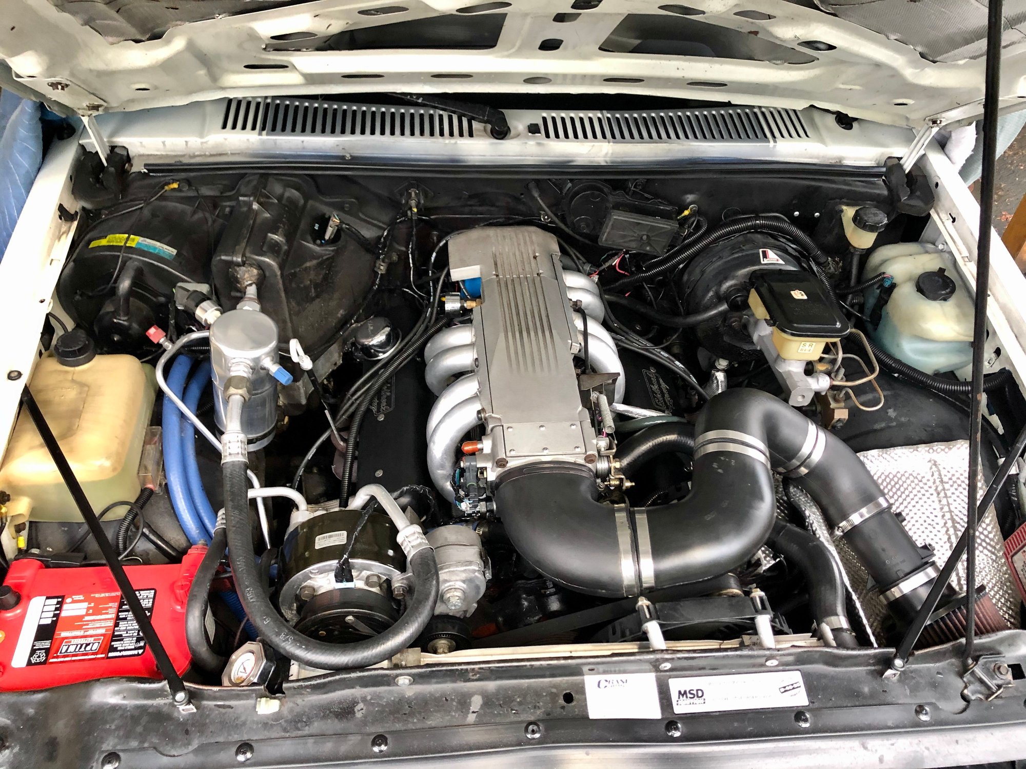

Hi,
im at my wits end, was hoping for some help.
what I have is a S-10 that I have personally swapped in a TPI 350 from a 86 Camaro. I did this swap 18 years ago. It’s a weekend toy but has had 15-20k miles out on it (35k on the long block.). Truck ran great and was super reliable for the past 18 years until now. (Used a brand new fuel injection connection wiring harness with the swap.)
A few months ago, jumped into it to go somewhere (was at home and sitting for 2 weeks) it fired right up and ran for about 15 seconds and died as if I shut the key off, cranked it and no start, it didn’t even try to catch. So I assumed it was a bad module since I have had them fail in the past.. so I deceided to not diagnose it and put in a new module .. what I ended up doing was installing a brand new Davis United Igntjion (DUI) , it was complete until( 50k coil, ignition module, cap rotor, etc..complete)
it would try to start after I got it installed, but wouldn’t fire. So I then took the msd box off and still no luck. I have 12:volts at the coil. Some times it will fire or try to fire and sometimes it just cranks. One morning it fired right up and ran great in the driveway for 15 minutes, I set the base timing at 6btdc with the ect disconnected. Shut it off, disconnected the battery and plugged back in the etc. Still with a warm engine, it wouldn’t start back up. Tried spraying carb cleaner in the intake and it still didn’t start.
ohmed the fuel injectors, they ohmed bad, so I put 8 new Bosch injectors in it and new fuel pressure regulator, along with both ect sensors. Still won’t fire.. sometimes it sputters and tries to run but won’t stay running, one time I had it to the floor and it would run for 4 minutes at 400rpm with the pedal to the floor. I am at a loss, I literally replaced everything but the fuel pump. (Walbro intank pump with 10k miles on it). I thought maybe the 9th injector was flooding it , so I bought a delete Kit and sent the prom to Harris tuning to delete the injector and use the 8 to cold start inrich
here’s what I replaced since this issue,
COMPLETE DISTRIBUTOR ASSY WITH MODULE, COIL CAP ROTOR
FUEL PRESSURE REGULATOR
BOTH INTAKE ECT SENSORS
SWAPPED MASS AIR FLOW SENSORS
8 new FUEL INJECTORS Bosch 4 hole
NEW ECM
SENT THE PROM OUT TO DELETE THE 9th INJECTOR
TPS SET AT .54
Fuel filter
new plugs and spark plug wires,
NEW IGNITION SWITCH
new OIL PRESSURE SWITCH
carb spray doesn’t seem to have a affect on it starting, so I don’t think I have a fuel volume issue. It shows 50psi while cranking
lit has spark, has injector pulse, 12 volts to the injectors, swapped fuel pump relay,
truck has no cats so it’s not a plugged exhaust, and truck ran excellent before it was parked. No Egr valve either. No codes in the ecm either. NO VATS in the system.
Battery is a year old and shows 12.36 volts and I checked the grounds on the back of the heads.
thank you for your help. Could some how the fuel pump not be putting out enough volume, but enough pressure? The carb cleaner in the intake does help at all so I don’t think it’s fuel. I pulled the plugs out and they don’t seem to be wet, but I can smell fuel, just not drenched in fuel. Again, the engine is super healthy and ran great before parked.
I also have one of those highway breakdown portable hei ignition boxes , i hooked that up to eliminate the ignition and still shows the same results. It cranks and cranks and sometimes attempts to run but won’t catch.
the aftermarket wiring harness has two hook ups, one key on and crank 12volt and one constant 12 volts, I made sure it has 12 volt in crank and run position as well
Thank you

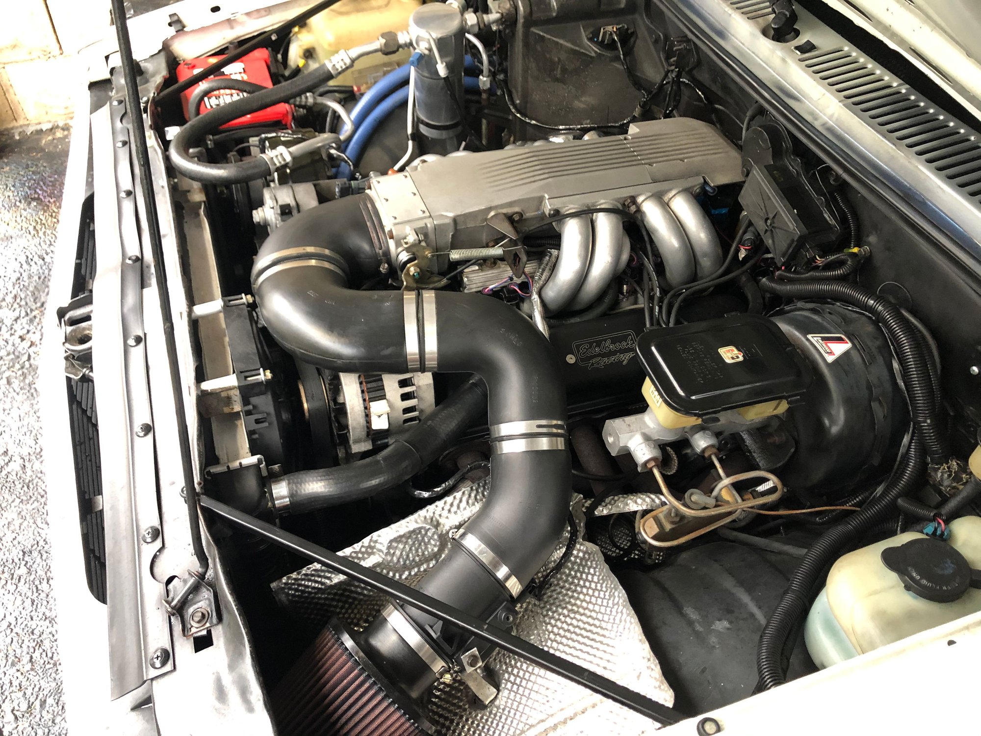

I rechecked this morning, I have injector pulse on both banks, 12volts at the coil, I have spark, fuel pressure is at 50 cranking, it sputters like it wants to start but won’t fire.
Sprayed carb cleaner In the intake, doesn’t change anything so it’s not a fuel delivery issue. Acts like it’s firing order is out, it is not, I checked it 4 times, and like I said, when I did get it running, I set the timing. Yes I disconnected the tan wire to set timing.
plugs are not wet.
my scan tool is not showing cranking rpm, but that doesn’t make sense since it has constant spark. I have a complete new distributor from DUI , that’s module and all. They are a American company, they built it for me prior to shipping it, it’s not Chinese junk.
tired Another good used ECM and same results.
All the pins look good and the harness looks brand new (has maybe 10k miles on entire harness.
this truck is about to get LS swapped if I didn’t already put $600 into fixing this.
