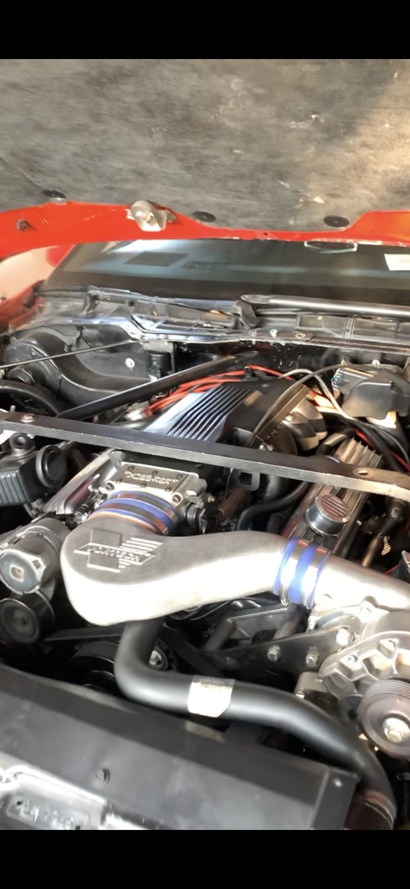

Re: Porting vs. aftermarket
I mean, just f*cking look at this thing

Hey guys, i ended up finding a pretty sweet used setup for a good price. Edelbrock hi flow ported base i’m gonna pick up next friday, edebrock ported plenum, bbk 52mm TB. I’m gonna get the tb and plenum tomorrow and just run those until i can pick up the base, which will come in at perfect timing as i personally believe i botched the intake gasket install last time i had it all apart so i can do it right this time. I’ll just run this setup until i can get some aluminum corvette tpi heads i’ll port and polish, which will also be perfect as i’ve got bad valve guides. This car has been setting itself up to get little (but important) parts fixed while i’m doing a big job pretty much since i’ve owned it. I swear the damn thing has a personality and mind of its own, like its sayin “oh hey while youre in there i need this too real quick” 😂😂
Old Sep 15, 2021 | 12:47 PM
1badroc_87's Avatar
Joined: Feb 2021
Posts: 22
From: Jackson, CA
Car: 1987 Iroc Z
Engine: L98 350 tpi, passenger side alt.
Axle/Gears: 3.23 LSD
As for the intake gasket, theres nothing largely obvious that says i did it wrong, car runs and idles smooth as ever, its just little things here and there that are synonymous. A smidge of bogging in the upper rpms before it powers through the rest, occasional rough idke at start for a couple seconds with slight but telltale sucking air noise, not often at all but its there
