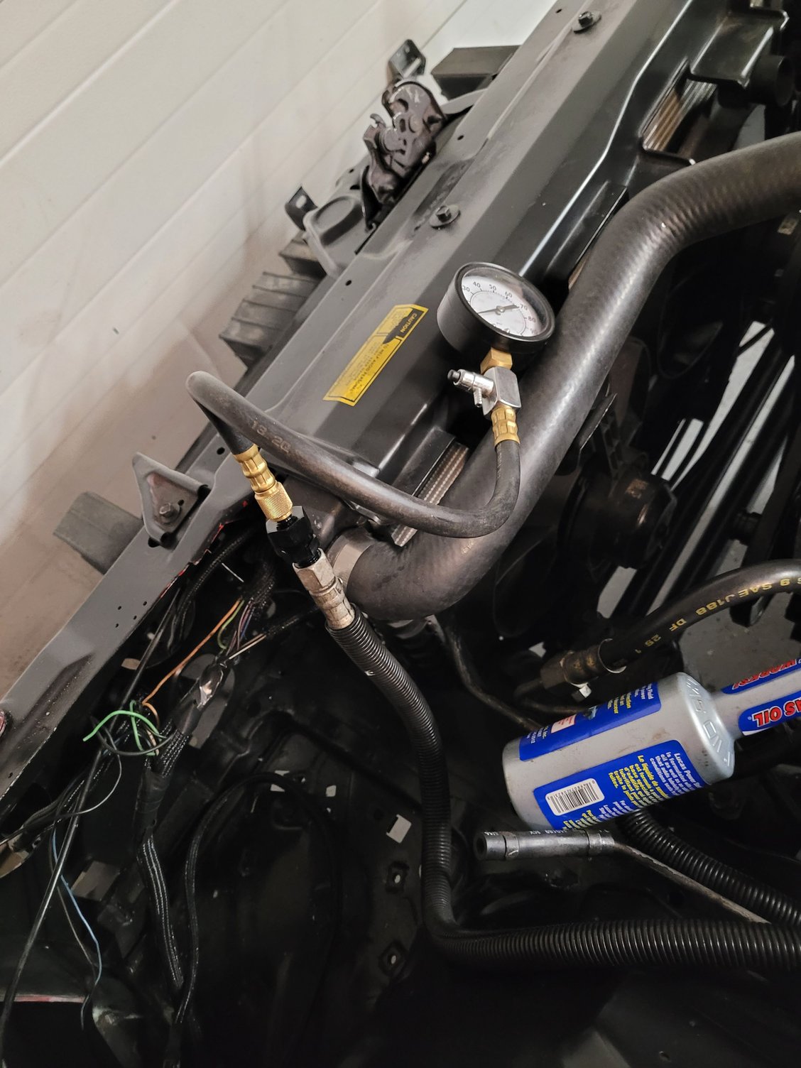

So I have been chasing once again a cold start and die on my L98 and have been through min air adjustment, replaced a faulty FP relay connector/relay. It has been weeks since the issue cropped up the last few days it’s been everyday I drive it.
Today I decided to look at fuel pressure which before had not been an issue. Also I changed the fuel filter last week and before that the previous one only had 10k on it and both had no blockages that I could tell.
After hooking my gauge up with vac hose still attached I am about 35 psi, with it disconnected it’s right at 44/stock where I set it. After searching some threads on here and checking my FSM I mounted the gauge on the windshield so I could see it and took it for a ride to see how it does under load…at WOT and pushing 4500-5k rpm on a deserted back road it won’t go higher than 40psi.
So am I correct in my assumption that the fuel pump is on its way out? It could be original with 89k on it.

Not bouncing around but I don’t like that it won’t go higher than 40psi

If you're at 4.5-5K and running OK (not missing and not lean), pump is not issue because providing volume regardless of pressure. Try this:
Turn key on and immediately start cranking while pump is priming. Don't wait until it's stopped. Could be that pressure is not being maintained after prime ends. Search for tests to perform to determine that, leaking injectors, etc. And are you certain it's priming given the relay was replaced?

Positive it’s priming, you can hear it for sure and it builds pressure, around 40psi IIRC. I noticed that over about 5-6 hours after shut down it bleeds down to 0 psi.
Injectors and FPR are both about 2 years old or so, no smoky long crank start ups and no fuel in vac line for FPR.
I will try that start up without letting it prime and report back.

The pump is actually starting to prime (building lost pressure) the instant you turn the key on. So when starting before the 2 second prime period ends, you have fuel pressure in the line enabling it to start and run.
Sure sounds like your pump's check valve is slowly leaking (based on your 5-6 hr pressure test), or you have one or more injectors leaking, because pressure is not being maintained. I'd first perform an injector leak-down test to see if that's the issue. If so, you know what needs to be done . If not leaking, then again, given you can rev to 5K without problems, the pump itself is OK and I'd install a one-way check valve as close to the tank as possible. Something like this: Russell 650603. Expensive at $35-40, but a lot easier to install and less than a pump, etc.

I will check out the injectors, but I have none of my old symptoms from when I replaced them a few years back like the long crank times when hot and smoky rich start ups, that will be a real bummer to change them again if they are leaky. Also I just thought at WOT while driving I would be closer to 44psi.
At this point I will likely just replace the pump and sending unit as preventative maintenance and maybe have a tank on hand in case the original is funky. I will report back if I replace the pump etc.

I am with you on this, I’ve been testing more and after bumping up AFPR to 48psi w vacuum disconnected( where I usually have it set) the most it will pull is 42-44 WOT and it’s been holding pressure really well after shutdown…but looking at the tank it looks original/has visible rust on exterior and looks to never have been out so I will likely replace the whole works as preventative maintenance…I daily drive this in the summer for a 100 mile round trip 1 or more times a week and don’t want to be stranded.

Yes the bleed down of pressure is a good way to check if injectors or FPR are on their way out too as well as that pulsator in the tank IIRC

I was also having some fuel pressure problems on my 350tpi and I wanted to rule out a pump verse a stuck/leaky injector. So I bought some fittings to test directly at the fuel supply rubber hose in engine compartment instead of at the Schrader valve on fuel rail. It gets up to 60psi quick on key on prime but it does not hold pressure so I'm blaming the check valve at the fuel pump itself. Here are the parts I used my fuel pressure tester is a female 4an yours might be different. One m16x1.50 o ring Saginaw fitting ( not sure if thats spelt correct) with a 6an male and then a 6an to 4an reducer

That is pretty slick, never saw anyone test fuel pressure there before but it makes sense.
I wound up just replacing my tank, sending unit,
and fuel pump just right before winter as preventative maintenance. Once the tank was dropped it had a good amount of rust on it…
I didn’t have much time to run the car before putting it away but it ran great. The only rub is the new dorman tank didn’t seem to like to take fuel as well as the original. I tried adjusting the filler neck but will have to wait until spring to see if it’s better.

Re: Fuel pump on its way out?
Oh really I wonder if the filler neck got a small bend/dent during install that could cause some filling issues.
From what I hear it’s very common on the aftermarket tanks. Could be shipping or manufacturing
