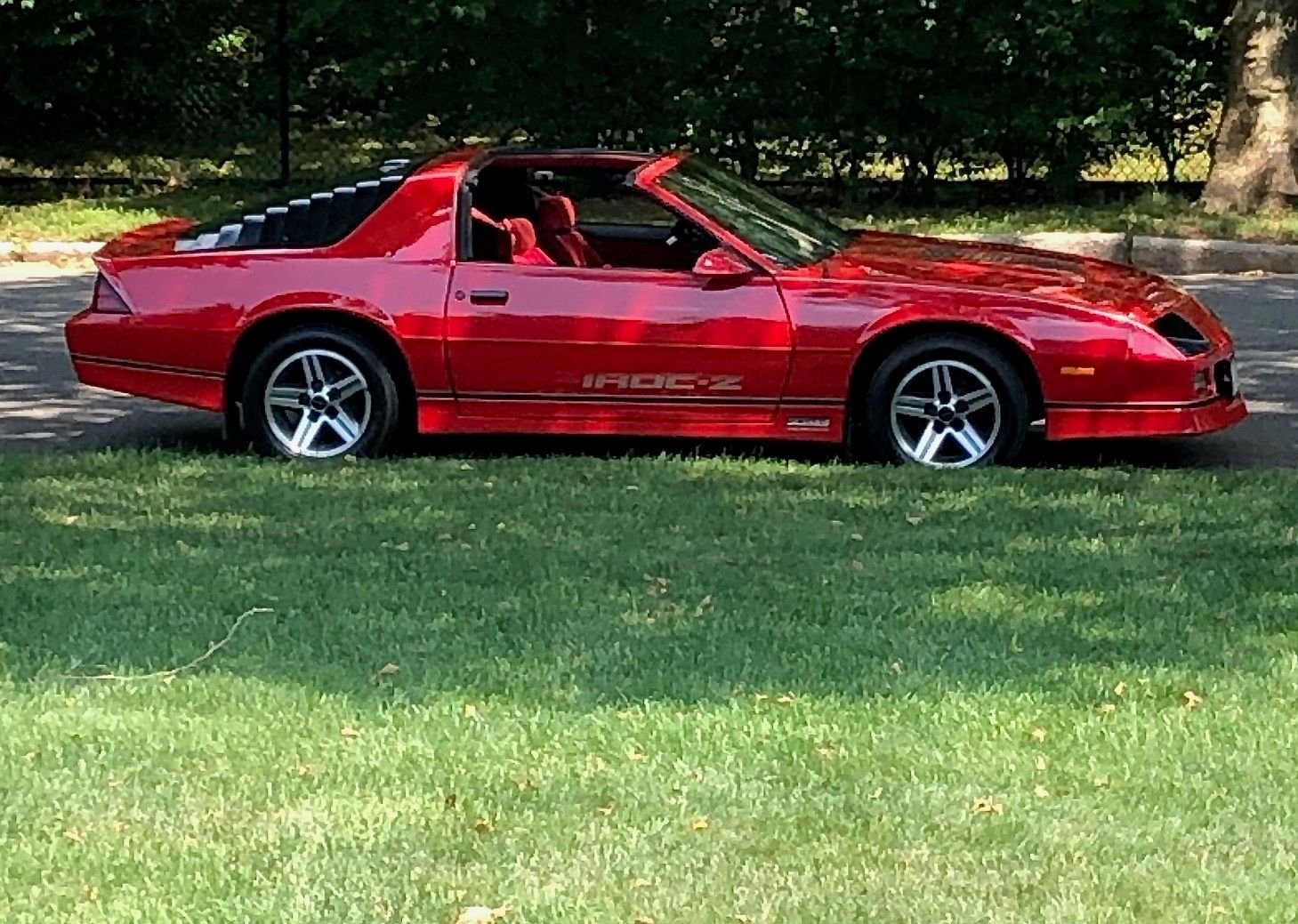

As an aside I bought the car brand new, special ordered it actually, back in '86. It was my first new car and years ago thought it would be cool to hang on to it. I had it off the road for a bunch of years stored in the garage when the kids were little, and it currently has 40K miles. I took it out of storage about 18 years ago and at the time changed the fuel pump, gas tank and exhaust since it sat so long. I'm seeing a trend - change my fuel pump every 18 years! Took this pic in the summer, just wanted to include it.....

What a beautiful car! Very nice! ...my first car was a red on red 86, but it was just a sport coupe, not an Iroc. Gorgeous!!!! ...and welcome to TGO.

That car needs a nomination for car of the month/year. Beautiful machine. I love that you bought it new and kept it all these years.

Appreciate the compliments! The car is a great conversation starter when it's outside. So good to have the Thirdgens get the credit they deserve!!
