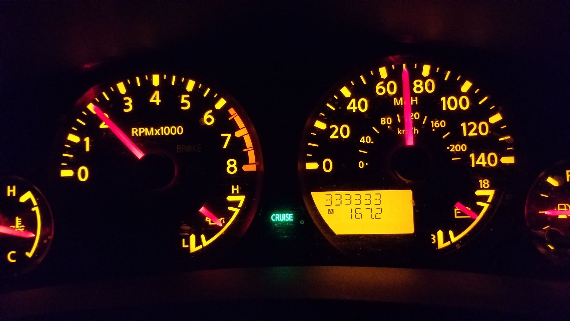

My current daily driver has 337,000 miles of clean, smooth operation, and it's still going strong. Here's a pic of its odometer from last week, January 3rd. I click pics every 10,000 miles nowadays, but I couldn't resist this mileage.
I put 309,000 on my previous daily driver, then I gave it to a friend after I bought this one, and it still runs flawlessly for him after his 6 years with it. No idea what oil he uses, but at least a lifetime on Max Life left the engine in excellent condition for it to keep going for a long time to come.
