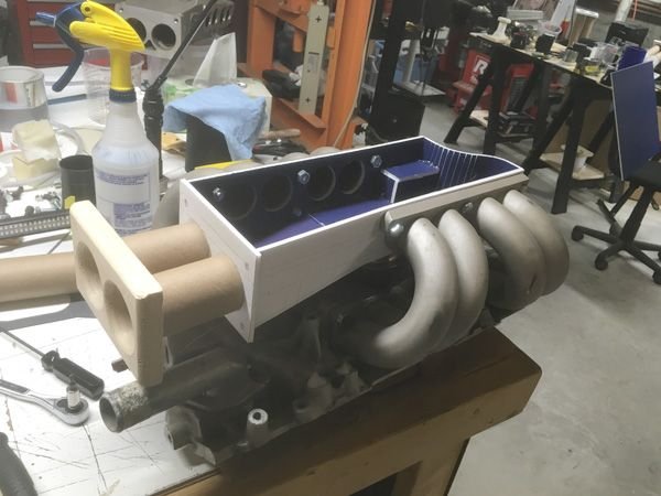

Air Flow In A TPI Plenum
I've been messing around with a TPI manifold on a flow bench.
Figured you guy's might be interested in seeing the plenum flow.

Here is some full Siamese runners.
Here is a side throttle like the First Manifold

Originally Posted by LiquidBlue
what is your conclusion?
Don't know if I have any conclusions yet.
For about 30 years I had a Paxton supercharged L98 with water injection before the throttle bodies.
I managed to hurt the pistons twice, always pistons one and three, and suspected the water was having trouble making the sharp turn into the forward runners.
Always wanted to visualize the flow and see.
Some interesting things.
With the dual throttle bores, the airflow from the bore closest to the runner blocks the flow from the other bore.
It gets deflected and has to turn around a come back.
Only runners six and eight are far enough to get equal flow from both sides.
Never realized that the throttle is so much lower than the runners.
The flow actually hits the bottom ramp of the plenum and turns up into the runners, especially the forward ones.
I think the side throttle option for the First Manifold would be a balance nightmare, looking at the different paths each runner set deals with.
Posted so others might see things I haven't?

Originally Posted by newbvetteguy
I saw on your YouTube channel you posted siamesed runner and monoblade throttlebody tests!
Am I just seeing what I wanted to see or does it seem that there is some reduced turbulence on average vs. the dual throttle body tests?
Adam
I think I agree generally...
It looks to me like the Siamese ports make it easier for the flow to make the turn into the runner pairs, and that may be a benefit of sharing the runners on top of the increased area.
The Mono-Blade does appear to have cleaner flow patterns and turns better into the runners also.
I'm in the process of adding another pump and recalibrating my flow bench, but I did flow the Edelbrock base, AS&M runners and 52 mm throttle combination.
Haven't quite matched the numbers up to what I see in the videos yet?
The lower flow in runner 1 makes sense.
Maybe the low flow in runner 8 makes sense being boxed in the back corner, it can only draw from one side.
The uneven flow in the center runner pairs is a little mystifying?

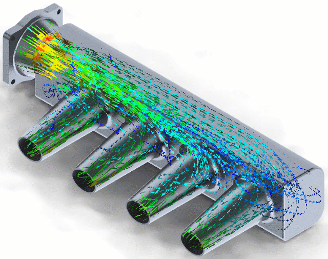

This might be interesting to look over....
https://www.goengineer.com/blog/mani...ulation-part-1

Wow. Yea it really is! CFD is so wonderful, when you can get it. (I'd LOVE to see a CFD animation of a TPI but I've literally never seen one, despite looking for a few years.)
I'm not sure that any of it matters for a TPI, because even if someone went crazy and built a modern "ideal' plenum for a TPI, they all seem to have the highest point at the very front of the plenum, right where you have the least hood clearance. Without chopping up a hood, it's kind of a non-starter.
It IS interesting to see the huge increase in velocity just on the plenum side of the throttle body in the top design vs at the tapered part of the runner in the 2nd one. And despite the higher peak velocity inside the plenum on the first one, you also have lower speed slow areas in the first design.
The top flow diagram shows the entry to the runners of tapered plenum design looking a lot more like a CFD diagram on a bell mouth inlet, too, while the square one doesn't look anything like it. Other than obviously still having vacuum in the plenum, the tapered plenum's airflow looks much closer to what I'd expect the airflow to look like with individual throttle bodies between the runner entrances and the plenum. -SO much less "plenum chaos".
-I'm not sure how much of a decrease in velocity is required to see fuel, water meth, or nitrous droplets fall out of solution, but those dark blue lower speed CFD arrows in the square plenum aren't going to help out any type of liquid injection prior to the throttle body, IMO...
Best engine-related post I've probably seen in a year on the internet. Thanks SuperZZ4!

Just keep in mind those are static flow conditions, no closing valves. When a valve closes the momentum of air crashing into the valve changes the flow and velocity profile significantly, depending on RPM and flow rate. Also reversion due to long valve open periods while the piston is coming back up the bore (around low rpm) further has effects on the behavior.
Dynamic situation of running engine far more complex than basic static flow condition. Though I suspect when the engine is making full power there is a closer relationship with static flow conditions than say, mid-range torque where VE is high but flow rate is lower.
To visualize what I am saying think of the velocity of air once a valve closes, velocity must approach 0 and probably reverses many of it's direction components to gain velocity in a direction leading away from the intake valve and back up into the plenum

SuperZZ4, I'm assuming by now you've about had enough "fun" with the TPI intake on the flow bench.
I AM curious whether a spacer between the plenum and the throttle body would potentially help air make the turn into cylinder #1 easier. -Just like a carb spacer can help give air a straighter shot to its destination (and slightly increase plenum volume), wouldn't a spacer between the throttle body and the plenum do the same? (Or moving the front wall of the plenum forward more?)
Adam

Adam ... this is all about learning to me and I'm never sick of learning.
My "keep busy" project this winter was to build a flow bench and I have a rather long thread going over in the Corvette Forum about it.
https://www.corvetteforum.com/forums...low-bench.html
Problem I always have is going off in ten different directions testing things and also upgrading and improving the flow bench.
I had the same idea as you and figured I would replace the stock plenum with my model and flow test it on the bench, then test removing the rear vacuum fitting bump and add three inches to the front of the plenum.
I'm not getting the same flow numbers with the model as the real plenum.
The balance between runner is generally the same but the flow rates are higher and the two bad corners ( #1 and #8 ) aren't as bad.
Think it makes sense that they are different, the model is smooth inside and the real plenum is full of things impeding the airflow.
Removing the vacuum fitting bump only increased the flow in #6 and #8 about +5 cfm each.
The three inch spacer lost -4 cfm in runner #1 and gained +13 cfm on runner #3.
So when things don't make sense, I take a step back and lick my wounds.
Going to think about what's happening and try the tests again.
Maybe add a spacer to the real plenum and flow test that.

Great stuff!
I have ADHD so I understand the "novelty gene" and having a lot of unfinished projects all at the same time.
I did not realize that the OEM TPI plenums had so much junk in them... Things are much less busy in my FIRST plenum.
I'm shocked at your results building the 4" spacer and that the flow to #1 didn't improve by doing that...
I remember Wilson making comments that when they design a custom plenum (front facing throttle body EFI plenum) for a customer that they like to have a big "hump back" design that increases the area just after the throttle body and into the plenum to slow the air down so that it can make the turn into the first runners better.
I included pictures from my FIRST throttle body and the plenum, just to show how much less junk is in the way of the airflow in it vs. your triangle EGR passage era TPI plenum.
