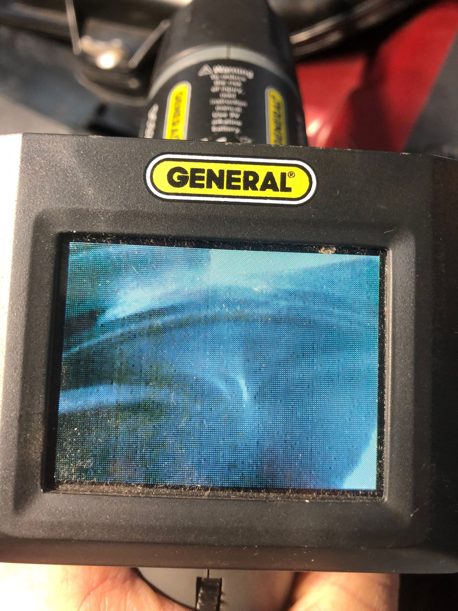

From factory (Camaro 1989 IROC-Z M5, LB9, 21k miles, stock to the core with premium gas, APYS tune). It knocks at mid throttle when engine is cold, audible and recorded on data logger. And no it's not due to the ALDL SA since it is disabled and 10k resistance is removed. It's terrible! Why? Because GM has the knock retard disabled until the engine gets warmer. That is safe all right, isn't it?. The engine knocks without any SA being pulled. Scary but factory. On top, GM adds timing when engine is cold at WOT to an already too high SA... with no knock protection (remember it's disabled)... very very safe! The reality is the factory tunes are mediocre with too much fuel and SA at WOT.
Let's also mention the rev limiter set at 10k rpm by GM... maybe it can be brought down a bit!
At the end of the day, to max out a street L98 and protect it, one needs a tune.

Honestly if the engine is knocking cold, then something is up. That is not normal. Sounds like timing is off or some significant carbon buildup due to long periods of inactivity. What is APYS tune? Aftermarket tune? Too much timing or too much compression is the main culprits of cold engine knocking. Also if the engine is 'retuned' the new tune has control over cold advance yadda yadda- sounds like a bad tune, improper timing, or carbon buildup causing knock.
I would never use an OEM ecu on one of these old cars. Use an aftermarket EFI Unit with seq-efi, individual cylinder tuning, injector phase control, if possible.
And also never rely on knock sensors or audible knock. Both are misleading. Knock starts way before human ears can detect it. Knock sensors calibration depends on the engine internal config and other factors nuance. When I tune an engine I use EGT and TORQUE characteristics to find the minimum best timing and work out the 'tuning window' to get an idea of how much safety factor is between the least timing and worst possible situations such as high temps, excess boost, bad gas, whatever might happen. Knock sensors should NEVER be used for tuning. The knock sensors come in after the fact to protect from bad gas and similar random occurrences IF they are capable, which they may not be. Sometimes a part changed inside the engine (did we ever change a part in an engine?) will affect knock sensor frequency calibration making them display knock when there is no knock, and completely silent sensors when there is a ton of knock. Not all ECU allow us adjust knock calibration frequency or knock sensor type, and even for the ones that do I would not want to deliberately test them by forcing the engine to knock.

"Sounds like timing is off or some significant carbon buildup due to long periods of inactivity"

No carbon deposit what so ever in combustion chambers. I could not access the valve train with bore scope, but I don't think it'll be necessary.
Like I said, too much timing from factory with ESC disabled at low CT. To Max out OP's L98, he needs a tune with proper timing for his set-up.
