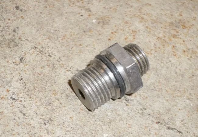

Re: 9th injector delete
This is what’s in the fuel rail that needs to be removed
Thanks! That's what I wanted to confirm, that a second piece comes off
