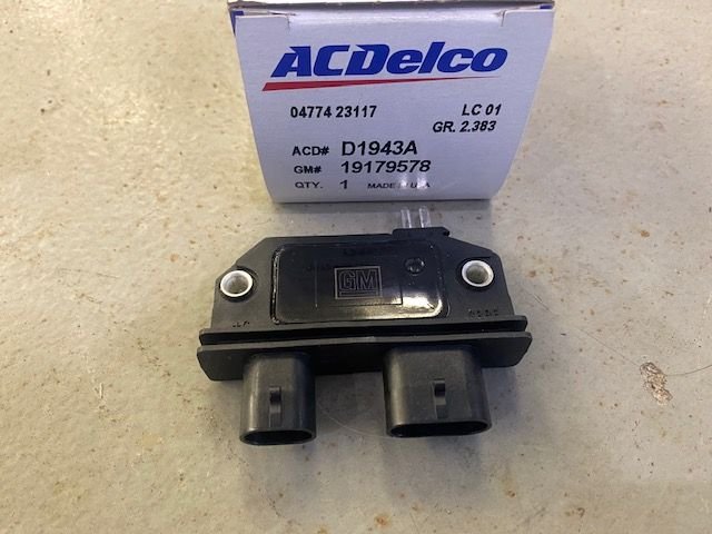

Just thought I would follow up & mention that I installed an AC Delco Module. Was surprised it said "GM" on it & made in the USA according to the box.
This module also jumps the timing at 1000 RPMs when in limp mode, Not 1400 like the originals, but does not appear to be adding any extra timing when the ECM is in control of the advancement, so problem solved on the module side of things.
