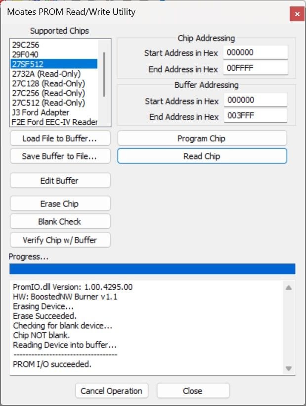

Is that adaptor the same as whats provided in this kit? Moates apu1 autoprom is no longer available so i think this is the best option now. I apologize because being as knowledgable as you are it probably can be annoying when talking to someone thats green a noob. But im serious about doing what i can to save this car.
and if so where do i revieve a tune to load onto theSF512?

I received my OBD1 burner from TUNERCAT, since MOATES is not available anymore. I have been able to log data and saved some logs with maf plugged in (car runs terrible stalls) and Maf unplugged ( Car runs great). I have used your expanded xdf, and converted adx, along with a AUJM Bin and I removed Vats and changed fan switch as directed. When i go to burn SF512 chip I get erase succeeded. Blank check....Chip not blank. And it just doesnt make sense. The chip is is the burner correctly notch towards handle with 2 spaces available towards handle. I am lost here.....

Where did you source the sst from, there’s some fakes that don’t reflash correctly and some even otp
I got chip from tuner cat website
tried datacat, tunerpro, and boostednw all three software same issue except in the tunercat software its says unable to locate programmer
