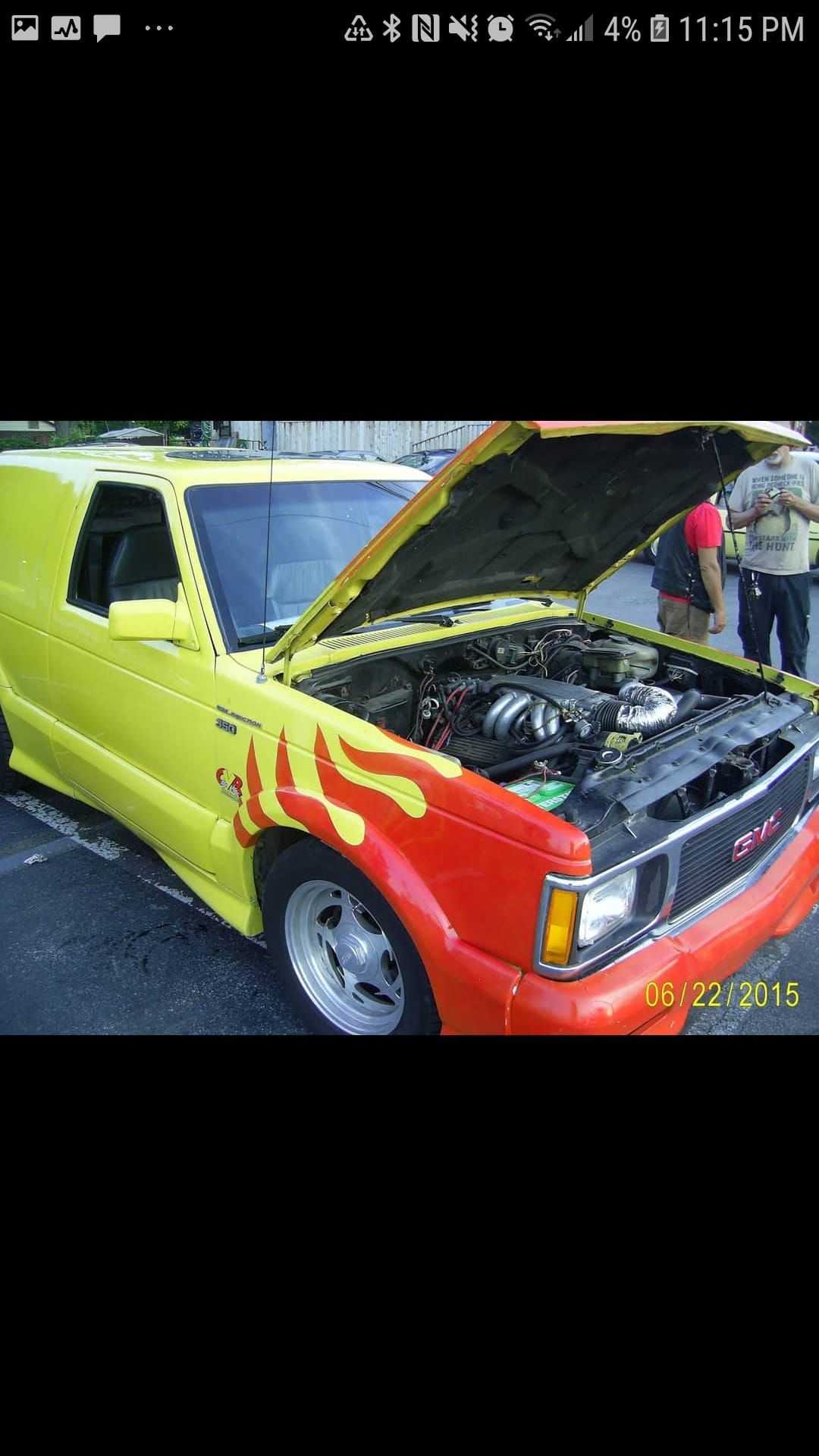

I purchased the ALDL cable to figure out what was wrong with my 350TPI, it's running rough and shooting black smoke...
Also set Latency to 16, then 30 still no luck, also min/max in device manager to 900 still no luck.. tried different drivers, also no luck.. I think that I'm doing something wrong?? OR my ECM must be cooked
someone please help me out here my poor 350TPI has been sitting there for 2 years now, I'm 20 years old and wish to know more about this old truck (1987 Blazer S-10 with a 1987 350TPI swap in it) It ran amazing for a long time then one day poof black smoke and wouldn't idle sorry for the lengthy post i'm honestly stumped
