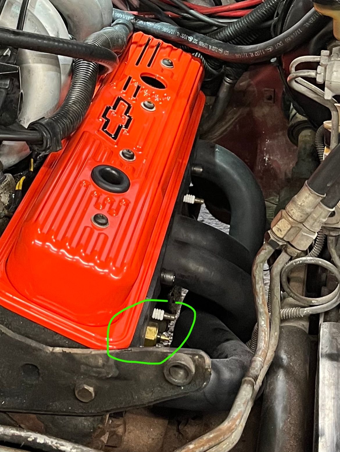

Here’s another strange thing, I noticed there is a sensor between spark plugs on cylinder 1&3 which isn’t connected to anything, I looked everywhere and I can’t find any plugs or wires hanging either. Upon further research I learned this is a coolant temp sensor. could this cause the engine to run rich somehow?
Can anyone post a pic showing what kind of plug is supposed to be connected to this sensor? And which harness do the wires run from? What color are the wires that I need to find?

No, that CTS is for the gauge. Wire might be green. Seems like a datalog might be able to uncover some clues about what's going on.

The gauge sender in the cylinder head requires a connector like this one linked below. It slides easily onto the flat round tip of the sender in a perpendicular manner.
Coolant Temp. Gauge Sender Connector, 89-92 TPI, 89-92 TBI (tpiparts.net)
The wires in the harness have little to no slack and only reach as far as the part they connect to, so if that connector is still hanging around in there, then it's not likely to be far from the sender.

Thank you for the info, I was able to find the green wire with the connector still present, Connected to the sensor and my temp gauge works now.

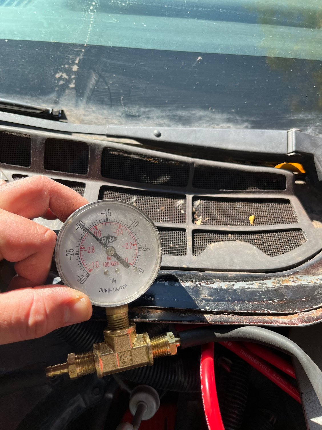

I finally got a vacuum gauge and checked yesterday (because this seems like a classic vacuum leaks problem), but from what I’ve read on this forum my 20” vacuum is right on the money for where it should be. Correct me if I’m wrong about that.
so now I’m suspecting a fuel pressure issue (sounds like that’s what you’re getting at as well).
renting tester to check fuel pressure today. Maybe fuel pressure regulator is bad allowing too much pressure through?
what about the MAF? I can tell you that when I unplug it the engine dies. So in theory it’s working, but maybe it’s reading incorrectly. I wish I could test it, I hate just throwing parts at this thing not know what the actual cause is. Especially something as expensive as the MAF which I can’t just return if that doesn’t fix it.

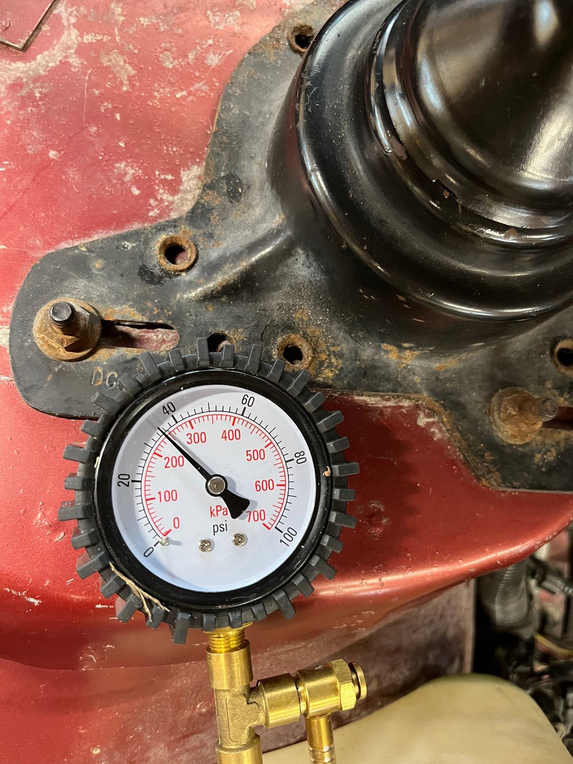

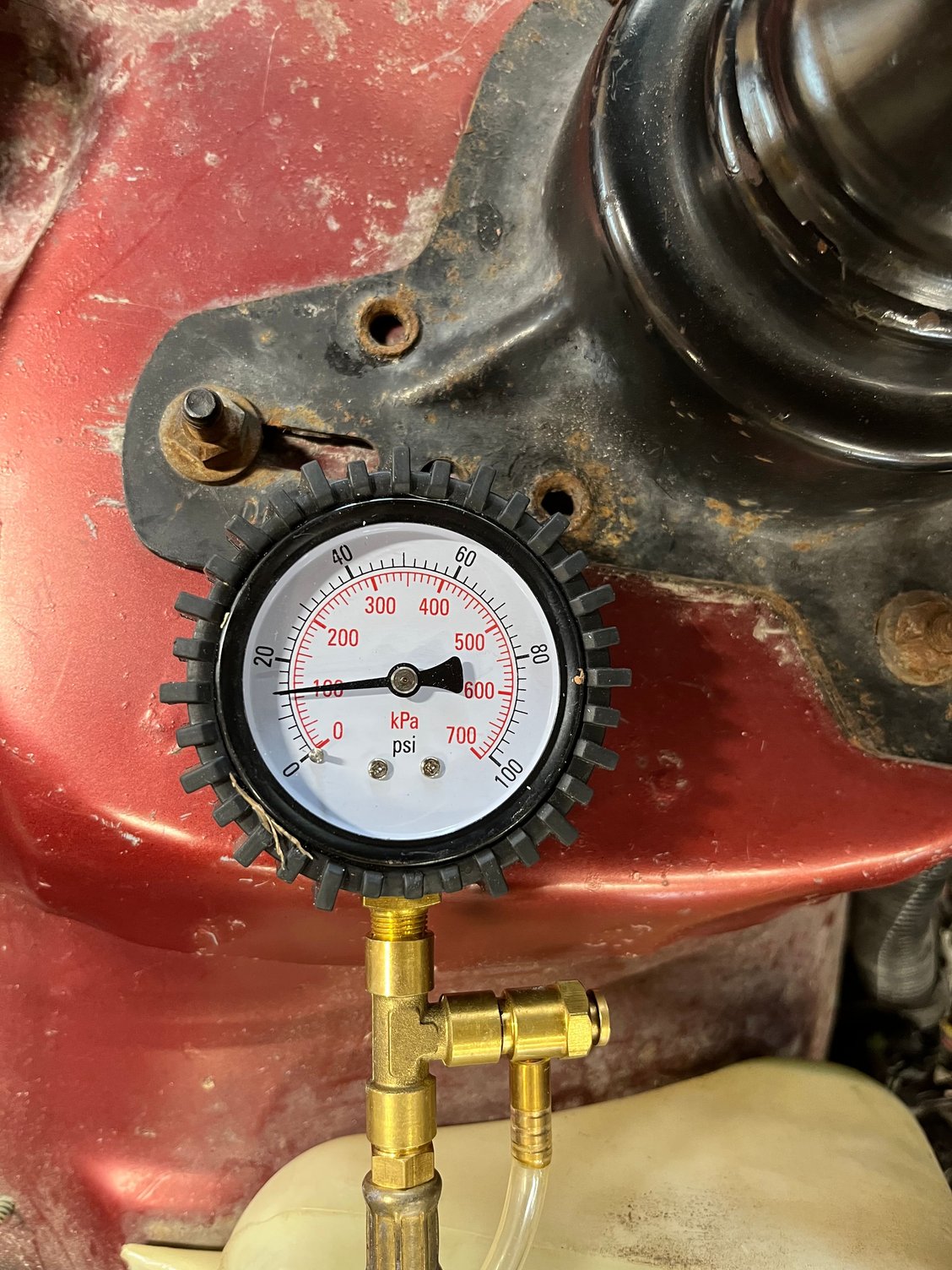

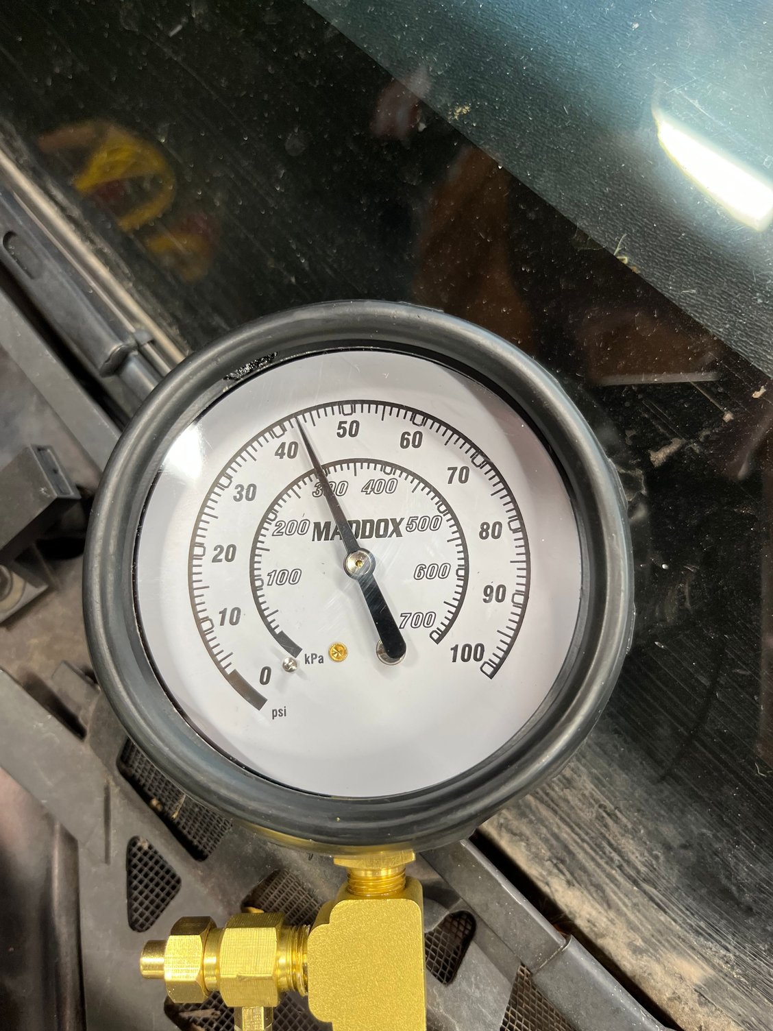

Update: I just checked fuel pressure, I have no idea what to make of this so please let me hear some opinions.
with the key on/engine off I have only about 15psi. I’ve ready in other threads this should be 40psi?
with the engine idling it looks like about 36psi to me, which should be correct, right?
What does it all mean? I assumed if I had too high of fuel pressure it might explain running rich….but if my pressure is too low, then would it run lean?

The FP should be 43(WOT)-35psi. 36 at idle should be normal. Your IAC is the main control of the idle and I see you replaced it. Did you do the IAC reset? Even if replaced it still needs resetting. There is a how to on the home page for this procedure. Also check the TPS voltage at idle, should be about .54 volts when the throttle is closed.

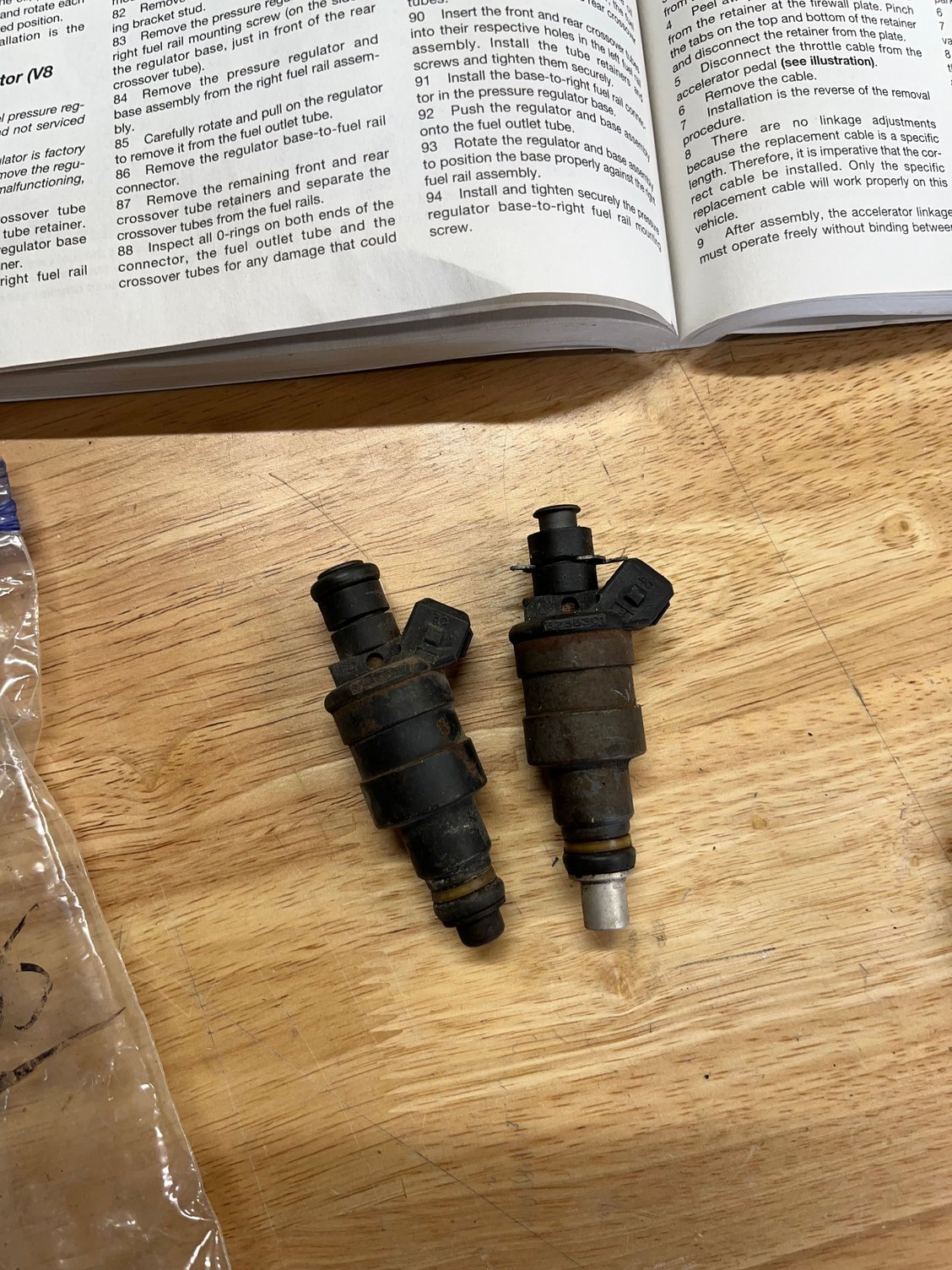

What injectors did you use? 305 and 350 use different flow rates and the brand matters. You may need to tune the engine to the specific injectors you used.
The O2 rich code. Don't fixate on this, a massive vaccum leak will cause a rich condition so this code could be stored from when you fixed this issue. Clear the ECM of it's codes and see if it comes back.
The low FP at key on could just mean the pump relay is not running long enough to bring the pressure up before start.

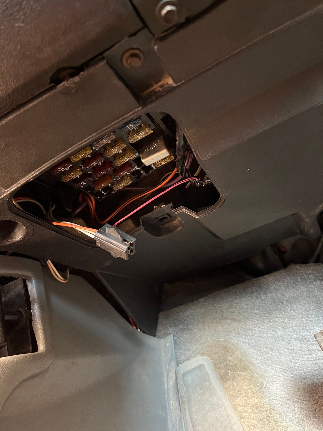

shouldnt I have fuel pressure with the key on and engine off? I just tested it again and I have 0psi, no pressure without the engine running

Can you hear the pump 2 second prime now that fuel
press is zero ?

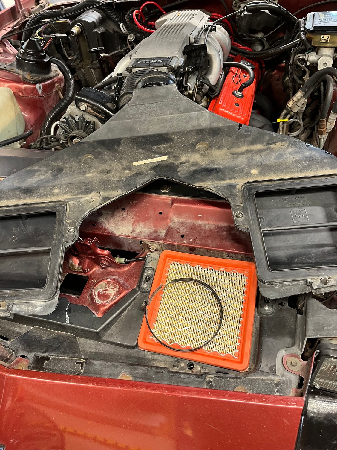

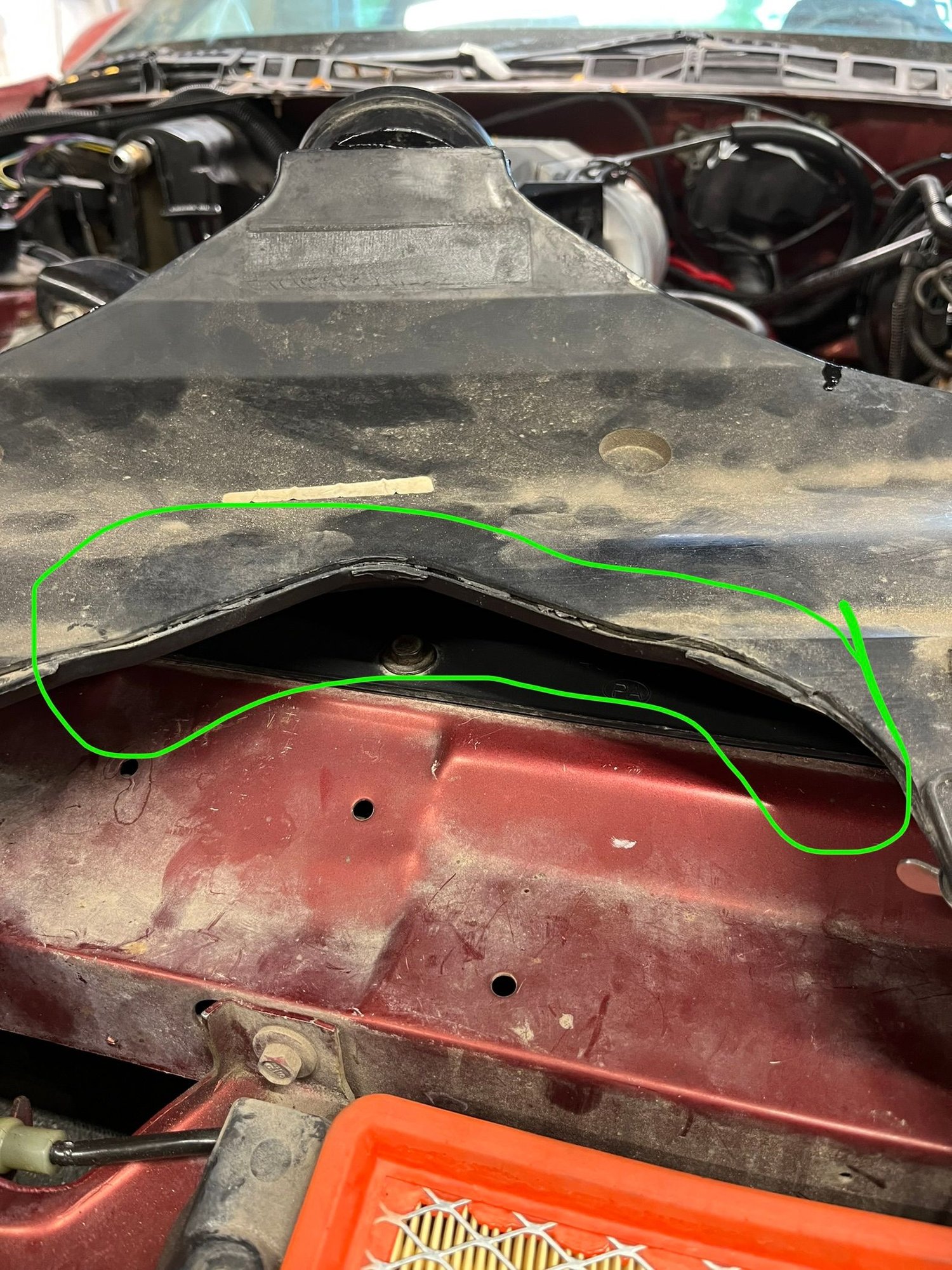

As for the injectors, the previous owner installed them right before I bought the car. He gave me the old ones, but I don’t know what he installed.
here’s an interesting but strange clue… I just unscrewed and lifted up the air box where it attaches to the air filters and the engine died, and will not restart. Why wouldn’t it run, it’s not like the engine knows the air isn’t being filtered…
and another clue, I flipped this air box snorkel over and I can see that there are some gaps where the top and bottom come together, looks like maybe there was a gasket of some sort in there when it was new. Going to seal up all these cracks with some rtv and see what happens.
still shouldn’t matter though which is why I’m scratching my head, maybe that little bit of extra air is messing with the MAF readings.
any ideas?

Can anyone tell me what this unplugged connector is for? Drivers side under dash fuse panel location

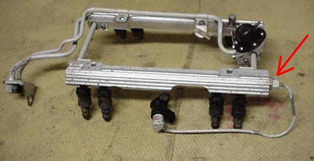

Below is a pic of where the fuel line for the 9th inj. hooks to the fuel rail. You can get a cap nut to cap that connection off. You may need a chip burned for cold starts if you remove this.
IMHO you are on the right track with thinking injectors. After injector swaps I'd say it's a 50/50 chance of them being tuned properly and most cases they engine runs rich. Your injectors are a mystery. Are they for a 305 or 350? are they even GM injectors? Flow rate? This is what I feel is missing here. The flow rate for a 305 is #19. 350 injectors flow @ #22. If you have a 305 and the OP put 350 injectors well there is your rich condition. You may be at the point where datalogging the ECM is the next step.

I've only been casually following this thread and am no expert (although I do play one on TV), and I agree with the above comments about more information needed on what injectors are in there. We really have no idea if they are even right for the car. It is also very common these days for people to install Bosch III injectors which don't typically work right without some computer tuning/adjustments.
The whole air filter removal/engine dying piece also seems like a very important clue, UNLESS it is causing something unrelated like accidentally unplugging the MAF while removing the air filter housing.

I have some new updates since I’ve been trying to diagnose this…i think it’s the fuel pressure regulator. In my posts above when I tested the fuel pressure I should have zero with just the key on, and 36 when idle sounds too low, doesn’t it? Maybe that’s as much pressure as the busted regulator can hold?
shouldn’t I be seeing closer to 40-45 psi at idle?
then I thought, what is the purpose of the vacuum line on the regulator that goes to the plenum? If the regulator is bad couldn’t gas be sucked directly into the plenum causing the rich condition?
Is there any way for me to be certain that the FPR is bad?

-I decided to verify how rich I’m running, I burned though 7 gallons of gas in 30 miles. That’s 4.3 mpg. 😬
-I think the fuel pressure tester I rented from oreillys was leaky trash, I could tell it had been rented by probably 9,000 idiots before me. I bought a new tester at Harbor freight, very different results.
This is with Key on (no start) fuel pump prime. 42ish psi…Good right?
I wanted 10 minutes to see if my regulator was losing any pressure, and it’s a little over 40 psi still…that shouldn’t be bad, right?
so what exactly does this mean? Doesn’t this rule out my bad regulator theory?

regarding my injectors-
here’s the original injectors, all have the part # 5235301
And here’s what they were replaced with (hard to see but they all have the same number)
I’m running out of ideas.

This is all making less sense by the minute, I just went through the small box of misc parts the previous owner gave me (mostly spare lug nuts)…and there’s an additional bag containing 7 injectors. The part # on these ones is 5235047.
here is is compared to the 5235301, the tips are very different from eachother.
I see vastly different info all over the place. which injector should actually be In my 1986 Iroc 305 tpi LB9?

These are the injectors that should be in your car:

just retested the fuel pressure from priming the pump and turning key off, longer test this time.
In 20 minutes my gauge dropped from 42 psi to 31psi. Does this mean my injectors are leaking?

Doesn't matter what injectors came from the factory; they're all bad now and should be immediately discarded. Your fuel pressure seems pretty similar to what mine does, I wouldn't suspect leaking injectors.

Right, I’m not asking which of these 37 year old injectors I should install. I agree, they’re all garbage.
the reason I would like to know which one originally came in the car is because I’m trying to determine if that’s what is causing my current issue. If they are the wrong injectors that would explain why it’s running so rich, and I will immediately order the ones you linked above.
I don’t desire to spend the $500 right now if that isn’t what’s causing my issue.
