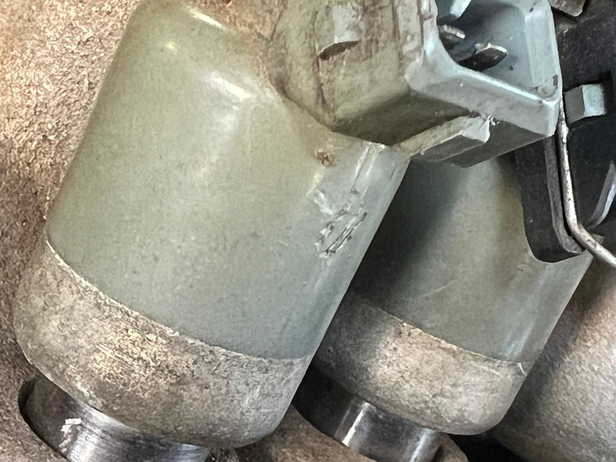

How do I check if they're original? I'll post a pic of them after work. They're grey if that matters

either send a pic or give me the part number off of the injector. I'll let you know if they are stock
didn't see the part number, here's a couple pics

Definitely a problematic multec injectors

Yup...those are the originals....as tuned performance mentioned...extremely problematic!!!
