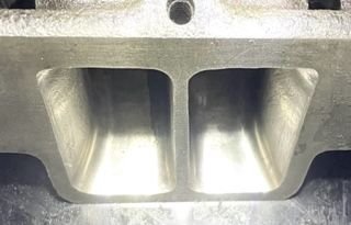

You can't let that stop you, ask yourself how bad you want it done... then get it done. Remember, you can calculate supported horsepower using a cylinder heads cfm flow, but then ask yourself what your engine is capable of making, not someone elses. Sure, there are heads that can flow close to 250-cfm right out of the gate, but 250-cfm supports close to 390-400 horsepower. So if you're not making that much, or plan to make that much with your 305 naturally aspirated, then what would it matter if one head flows this and the other head flows that on the bench. You said yourself your engine pulls good for what it is, and you'd like to enhance on that, or improve on it. Yes, companies like Brzezinski stopped working on open chamber heads, but that doesn't mean it can't be done. Companies also stopped tuning OBD1, but we're still here doing it. If you're curious, here is my most recent set, upper and lower sides of the ports. Still have to finalize polishing, and the guides have been taken all the way down in the bowls, but you get the gist. These are going on a stroked 305 to 334, and they will do just fine. You don't need Vortecs...
- Rob
