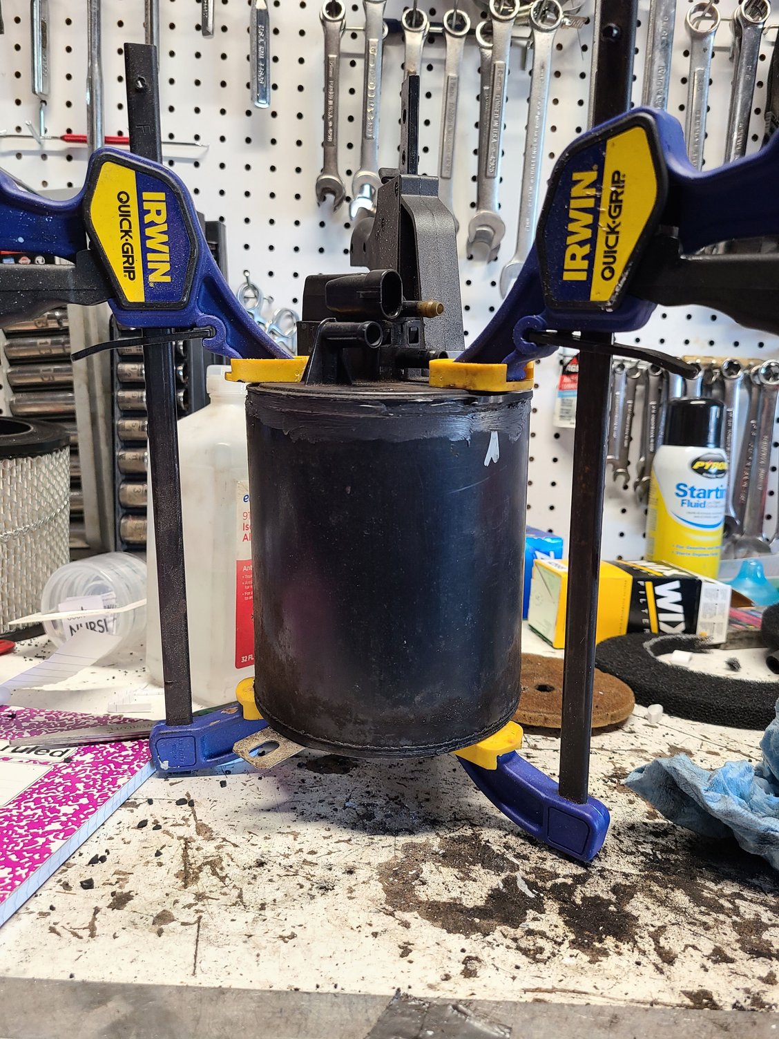

So im attempting to repair the charcoal canister. Cut the top off. Emptied the pellets, replaced the charcoal with activated charcoal from the pet store. Also replacing the filters witg carbon filters from the pet store also. Currently waiting on the rtv to dry. Once thats done give it a good test drive. Also replacing the purge valve, even though the old one seemed to work. The purge solenoid still works. Fingers crossed this solves the problem. The old charcoal definitely stunk of gas. Had to keep my garage opened majority of the day.

Thanks for the photos. Do you have any others like the underneath side of the top and what was down at the bottom? Was the whole thing filled with charcoal?

RTV probably not the best choice for something exposed to gas or fumes, but give it a go. I used plastic epoxy to put mine back together.

I did not take any pictures of the inside. Hindsight i should have. But inside mine was a tube that is connected to the top. At the bottom of the tube is a screen to prevent chunk going to the engine. Theres a filter at the top and a filter on the bottom. Filter on the bottom sits on a cone shaped basket. The tube goes through the center of this basket and is a chamber with no charcoal. Im not worried about charcoal getting into the motor seeing how it would have to fall through a filter layer and some how go through the screen on the tube. Now the rtv, my thought behind it is one, its what i had on hand. 2- it holds up to oils decently so f-it. Give it a whirl. I did drive the car today for about 30 mins with ac on. No fumes. Took cap off after driving no hissing. I'll call this a win and yes, ill monitor the rtv.
