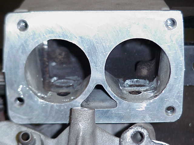

I opened my bores to 52mm with a clean shot straight through.
The EGR is still intact and seems to be working ok.

Here is a front shot.

The outlets just need to be matched to the gaskest and mabe
a tad more and clean up the inside around the openings as best
you can. Or open them up to match whatever runners you may
be running.

I appreciate the benefit of your experience. So far I havent spent much money, just ported the plenum with tools I already had and bought a Jet airfoil. While I am not poor, I certainly don't like throwing my money away on stuff just to have a cool signature. I have already ordered the K & N 360 degree filter and bought a few items to fabricate a homemade cold air setup, probably $75 total for the whole deal including the filter. BUT, Im fixing to get into the pricier items and would like to get the most bang for my buck. I realize there are other things at stake besides HP and ETs, like a nice catback system that sounds good. That can add to a satisfying driving experience, but I really want to go fast more than anything else. My car already looks great. I don't want to seriously modify the car for only drag racing, Im looking for a balance between the strip and the street. The car is not an everyday driver, If I want to go on a long trip Ill drive my Crown Vic, heehee. Anyway, looking forward to recieving the info.
