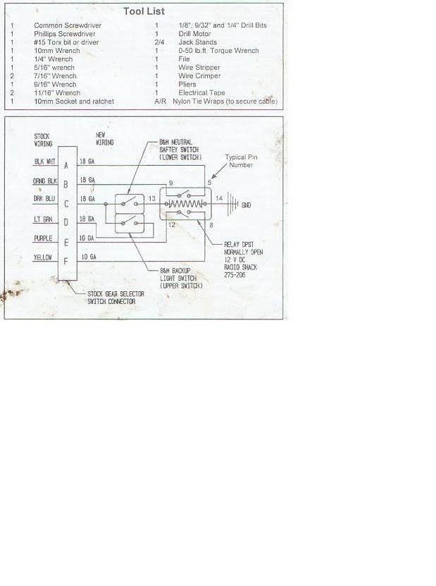

first off let me say i shouldn't have gotten the shifter. the only good thing about it is the looks. how do you wire the neutral safety switch and the reverse lights switch? the instructions suck...they don't even say what wire goes to what terminal on the switch or does it not matter? i hooked up the wires and tried cranking the engine over but no luck...anyone with experience in putting these things in please help.

I really dont understand why people cant install this thing,
maybe you get the wrong instructions, if you didn't get the one specific to your car...When I installed mine it only took me like two hours, all I neded to get was some wire and the box thing (cant think of the name right now) well hope thihs helps.
Old Nov 12, 2002 | 01:05 AM
SuperchargedRS's Avatar
Posts: 424
Car: Camaro of course
sorry wrong thing, here ya go.

I installed one, and used the relay, and the stock shifter cable. I dont have the car running yet though(hopefully soon) so I am not sure if I got the wiring right. Oh, one thing your instruction sheet has that mine didnt is it tells which set of the plugs on the shifter is the ones on top. I had to guess. I guess I can check it out with that pic you posted

how do you know what switch is supposed to be the top and what switch is supposed to be the bottom? both of my swtiches are identical so im guessing it doesn't matter???

on that pic he posted it shows upper switch and lower switch and what each does.

Mine didn't take long to install either. At first I did not install the relay. However, when I got into PROM programming I realized how important this little bugger is. If you DO NOT install the relay the the ECM will not know that the car is in Park or Neutral. The relay drives the P/N switch.

The switches are the same. You just have to make sure you hook the wires up right. You have certain wires for the top switch and certain ones for the bottom. But yes, both micro switches are the same.
