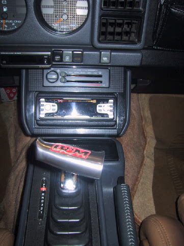

The megashifter install comes with 2 brackets on the console model type. You mount the shifter onto these brackets and then cut out the shifterplate with the template provided. They have a new metal shifter plate that you drill and put screws into the OEM plate. This covers up the hole that was just cut and allows more clearence for the shifter. They come with a boot (don't spray any kind of leather protector on it or it will crack and rip).
As for shifting with the megashifter... you pull up on the reverselockout (little trigger in front of the handle) and you can pull it straight back till it stops... that's OD (on a 700r4, would be 3rd on 350 or 400) it's made so you can't go any lower with the trigger pulled.. bump it forward once you're in neutral. Pull it back one click you end up in OD again... pull the trigger and push it forward twice and you'll end up in Rev.
To downshift from OD just pull back on the stick... only lets you downshift one gear at a time. Once you hit first, you can hammer the stick forward for the next gear, only lets you go forward 1 per time. Once you hit OD the trigger will beable to be pulled up... I use this as a last gear check.
Mainly it works just like OEM shifter with improved shifting (one gear downshift and one gear upshift).

Do a search on megashifter installs... you will have to cut out the whole area where the OEM shift mounts (idicator plate part too).
You cut out the area where the shifter mounts... drill out 4 holes and bolt a new metal overlay down. It pretty much covers the area from the window switch's to the ash tray part (on a firebird console, Camaros should be just like it).
The lever is just for Park and Reverse... you pull the lever (mine pulls easy) you ripe the shifter back into OD. It's not a big deal... it's a little harder to go from Park to Reverse... but I think it's easier to go from OD to Reverse.
Once in OD you don't use the lever anymore unless you want to go to Neutral or Park (the shifter prevents you going to lower gears with the reverse lockout trigger pulled up.).
Megashifters are also multipurpose shifter... theres a bolt that mounts in the gate path so you can go 2,3, or 4 speed transmissions. That way you can run 350/400, 700s, or powerglides.

Without the original plate the shifter won't have anything to bolt to. The new trim plate bolts on the old plate and that old plate bolts on the console.
The megashifter console model comes with a new indicator slide.
Here to clear up the confusion I stole this from another member on the board. This is what you want to cut out of the original to put the new trim plate on top.
