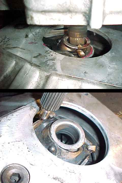

Which of these 2 ways did you put the fork into the throwout bearing?

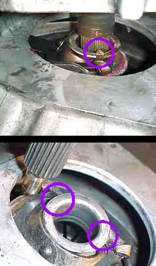

Not that, it's the same in both pics....
Look at the 2 little ears of metal that are part of that little spring thing that's riveted to the fork. In the first pic they're on the outside of the groove in the throwout bearing; in the second, they're inside it.

Well, if the metal teeth are up on top of the throwout bearing, outside the groove, then that's your problem. They're supposed to be like the lower pic, where they're inside the throwout bearing groove.
If they're outside the groove, they will hold the throwout bearing away from the fork by about 1/8", which translates to near ½" of slave cylinder travel. This will force the clutch to adjust itself to that point, and what you end up with in effect, is only about ¼" of slave cylinder travel that's actually doing useful work. The first half or more of the clutch pedal's motion is doing nothing except taking up the slack from that little spring.

No, the upper pic is the wrong way, where the spring is outside the throwout groove.
