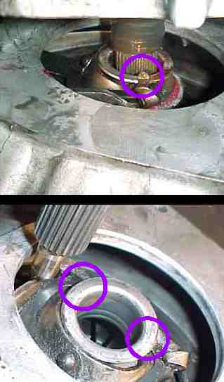

Which one of these 2 ways did you put the throwout bearing in the fork?
Attached Thumbnails Clutch Problems! Help!!!-throwout-fork-right-wrong

I was waitin' for that RB.....
I bet you wish you had a quarter for every time you've posted those pics
Old Jun 8, 2003 | 11:25 AM
RB83L69's Avatar
Posts: 18,457
Likes: 16
From: Loveland, OH, US
Car: 4
Engine: 6
Transmission: 5
:sillylol: I'd be even richer if I got a quarter every time somebody put it together wrong, and I didn't get the chance to post the pics for them!!!

NAahahahaha after three weekends I've found the problem!!!! The %#$@% throw out bearing was in backwards, so the small side of the throw out bearing couldn't disengage the clutch. I flipped it over so the bigger side of the throw out bearing was facing the fly wheel, BING mother#%$&-O. Its DONE, well thanks for all your help.
