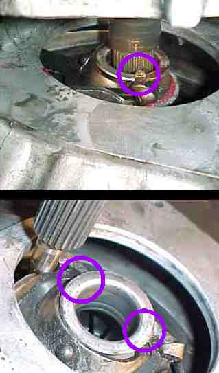

I don't think there is a difference between the WC and non WC bellhousings. I also don't think there is any adjustment in the stock pivot ball. I don't think the T/O bearing was installed backwards, just improperly. I'd remove the trans and check the way the bearing is installed.
Attached Thumbnails Adjust pivot ball/bleed slave or.......-throwout-fork-right-wrong

i was pretty sure about the bell's, and i thought i was sure about being able to adjust the pivot ball....
i look at those pics and i cant relly see whats the difference, assuming there is a difference

I guess I should have stated the top way is correct. Look closely at the fork tangs and you'll see the difference. On the top pic the tangs are on the outside of the bearing and on the bottom their in the middle in the groove.

I know this is 13 years old, but I found it while looking for other info, and I "think" there is some wrong info. The little tangs on the fork do NOT go on the outside of the throwout bearing. The tangs go INSIDE.
...just in case someone finds this later.
