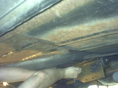

Ok, I got the kit, its bolted on to the tailhousing. Took apart the TA bushing assembly off the 700R4, its in two pieces. How do they go together? I have no idea and the instructions arent helping me..

there should be a slot in one piece and a tab on the other. slide that tab into the slot on the other one. you might having to do some finageling to get it to go in. then screw it together with the supplied bolt. mine went in fine. that is how i remember it but i can recall off hand.

So where does the piece with the long stud go? There doesnt seem to be room for it...

I've never seen the B&M unit, but I removed the bushing half
from the plate with the long bolt and bolted it to the bracket I made. Can someone post pics of the B&M bracket or scan and post the B&M instructions?

thats what im missing i guess, removing the bushing from the larger plates???

The piece with the long stud does not get used...or if it does the long stud does not connect to anything...it has been a while since I did the swap...I will look tomorrow and let you know for sure.
