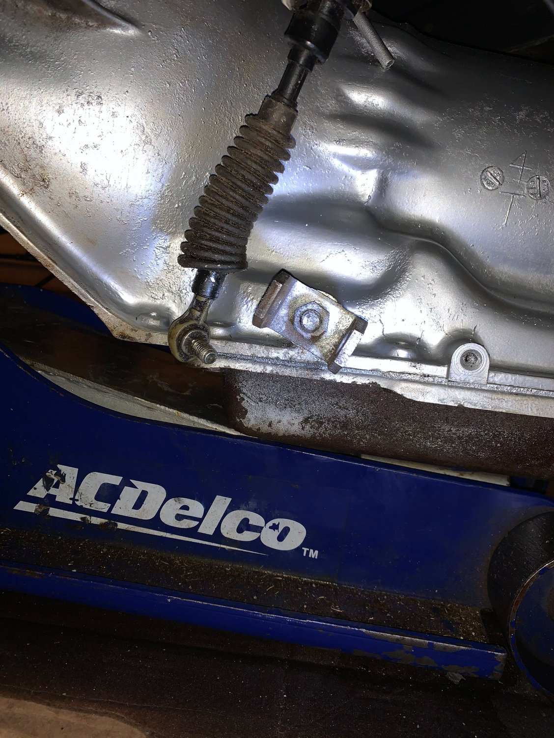

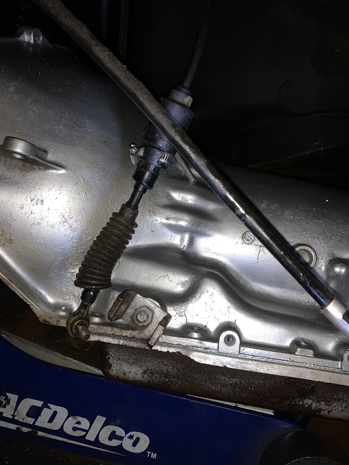

Old Feb 24, 2020 | 07:06 PM
Sdw100's Avatar
Joined: Feb 2020
Posts: 1
Re: Th350 swap - shifter options
Do anyone have a photo or any information for using my stock shifter for a th350 swap? This is What I’m working with.
This is the bracket I have purchased, anyone know if this is the correct bracket?
