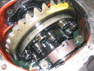

i dunno if this will help, but i had it, maybe somthing will be easier to point out in this:

No those are the main bearing caps. On a 9 bolt you don't need to remove the rear cover to pull the axles.
Pull the wheel off. If drum brakes, pull the drum off. If disk brakes, pull the caliper and rotor off. In behind the axle flange that the wheel bolts to, you'll see 4 bolts around the axle. Those are the bearing flange bolts that hold the axle in. It's the same as a Ford 9" design. There are no C-clips to remove so the rear cover doesn't need to be removed.
