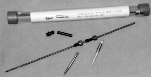

Having a drum rear will make pulling the axles easier. Also, be perpared to find that the differential cross shaft retaining bolt/pin is broken (if you like doing burnouts), in which case you will need a new one, along with the extraction tool kit (which is cheap).
What extraction kit are you talking about? If there is one, I need it. Mines broke. Where Can I find one?? Here's what mine looked like when I attempted to take my one-wheel peel rear axle out. I gave up and threw it back together :
Yes, there is a removal kit. I got mine from snap-on, but it is made by somebody else, like Lisle or something. It comes in a long plastic tube about 20" long. There is a long semi-flexible drill bit, a threaded insert/guide for the drill bit, an easy out, and instructions. This kit works awsome, that pin will be out in no time.
You can try going to sears, I think the sell it in the tool section. Or you can try napa or autozone or something. Worse comse to worse, I will mail you mine so you can use it, then just mail it back to me when you are done. My email is fisherbody86@hotmail.com. Email me if you need my kit.

Here is the kit, and a link to read about it.
http://www.skywaytools.com/autopg2.html
Awesome!! Thanks alot for the link AND the offer! :yes:
