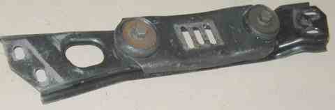

the crossmember is 2 peices a upper and lower part so theres the
transmission
tranny mount
metal plate
2 body looking bushings
metal plate
and all 3 cars were like this
transmission
tranny mount
metal plate
metal plate

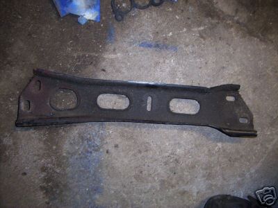

Originally posted by TomP
There was a design change for the autos, though. See the pic Randog gave us of the crossmember? See the two ovals on either side of the center bolt hole?
Supposedly the center hole was cracking b/c of stress. So GM came up with a secondary trans mount. Instead of the two ovals, there became two bolt holes. A flat bar got bolted across the middle of the crossmember, separated by two flat bushings. This flat bar had a hole in the middle, which the regular trans mount bolted to.
But I believe this change was also moved to the v8 models.
Gotta love GM!
Gotta love GM!

the V6 cars are funny, i had no idea they had so many different ones... I think theres like 1 selection for a tranny mount for a V8 from 82-92
the normal (at least V8 version of the auto xmember) is just like the one in that pic, and the tranny mount bolts right to it
well I hope it works out

ok i found a pic of a 2 peice crossmember although he has cut 2 extra slots in the middle.
picture taken from RB83L69
edit: also the crossmember came from a V8 camaro with a auto trans, i dont know the year tho

ok so i get the crossmember from the exhaus shop welded togther, looks like it will work... bolted the mount up to the trans and the crossmember is moved a bolt hole towards the front if the car fine but the tranny mount dont line up with the crossmember hole at all, ive tried it every way possible and no luck...
maybe my cars just really special and needs that $380 extra special tranny mount from the dealer.

i took the cheap $9 tranny mount and drilled bolt holes far as i could back and then took the crossmember and drill holes in it far as i could.
installed the tranny mount, 1 side of the crossmember, then got the tranny mount bolt to go through the crossmember then pryed the F'n out of it to line up the crossmember bolt holes with the frame rails, it works but that tranny mount bolt looks like it has some stress on it as it is being pulled to the rear of the car on a angle.
all i can say is there is a major differnce, shifter isnt jumping up and down as much anymore, there is a little bit if i blurp the throttle but not to much.
so i got a poly mount on order wich should come in the next few days and i guess look for this other kind of crossmember.
but this all is so much BS, good job GM you *******
thank you all for the help, very apreciated

ok i got the 1 piece V8 auto crossmember today and it bolted directly up with my engergy suspension poly bushing.
1 question tho, i installed it with the preload plate and the car viberates MAD and is much louder, pulled the preload plate out and it runs better but is still pretty loud and viberates. this is normal right? i didnt expect it to be this bad.....
