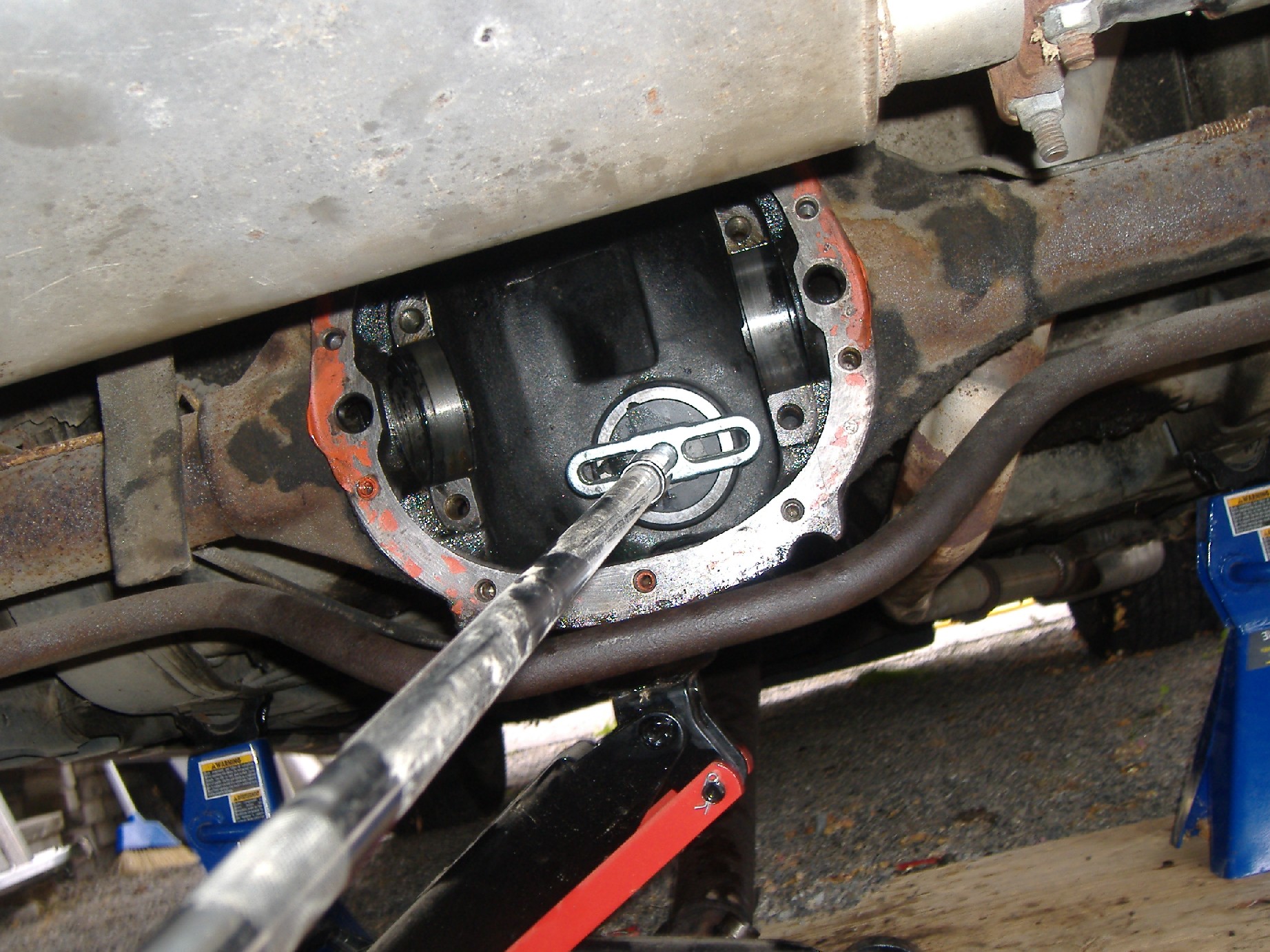

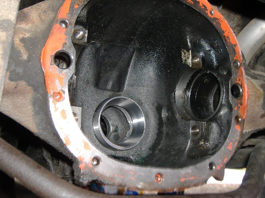

here is the working area with race in as much as it will go

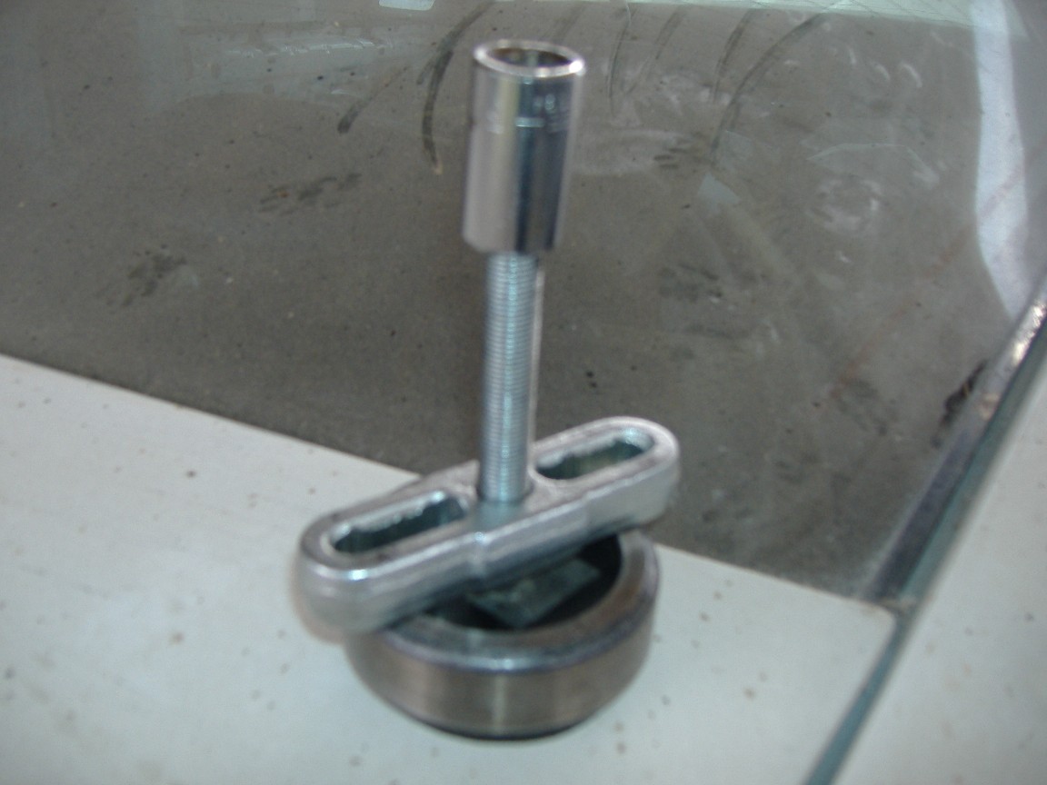

here is the hockey puck tool

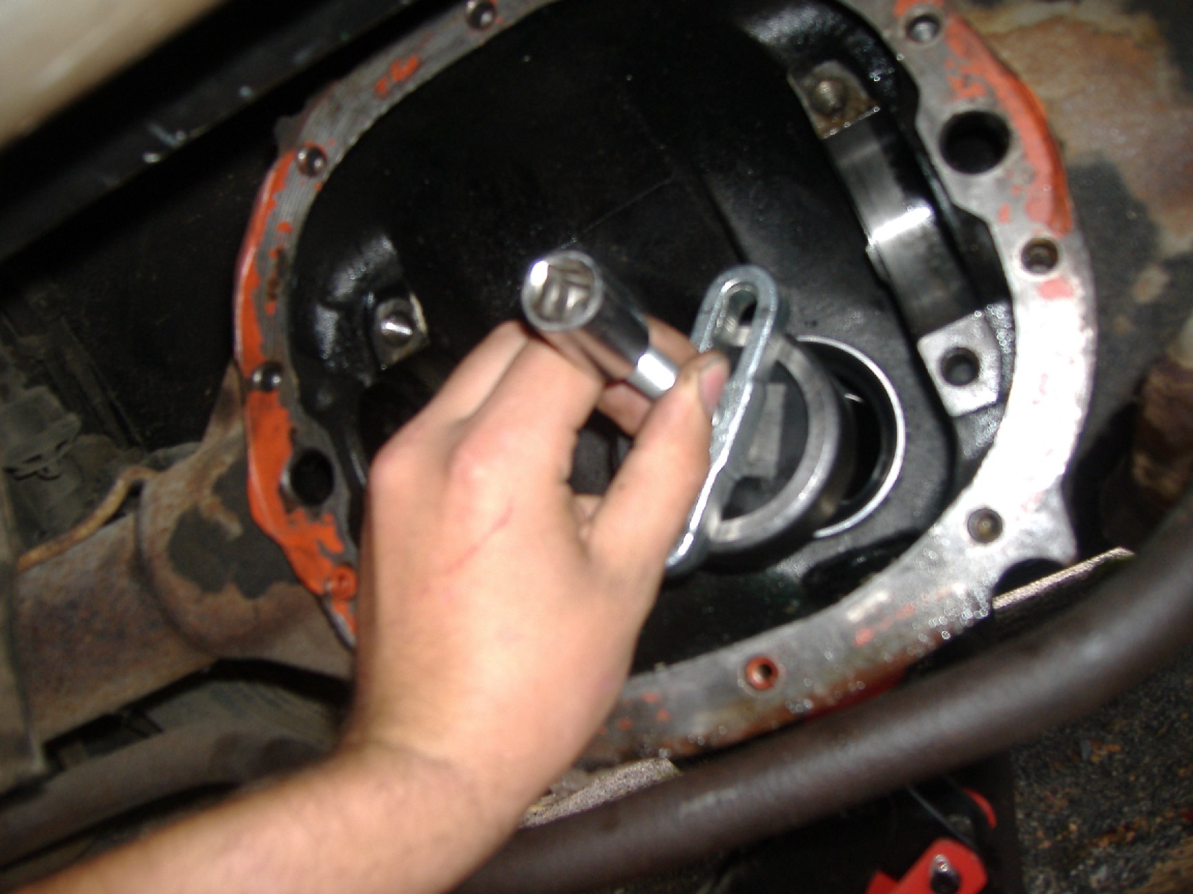

here is the tool at work. let me know what you think. why wont it go in?!?!

Definitely give this a try. I did that for the axle seals and they went in like a dream. I didn't change races in my 95 formular buildup/swap because they weren't worn. Nice idea with the hockey puck but it might have to much "cushion" to drive in any further.

Yea, I think that puck is absorbing your hammer whacks too much, I wouldn't use rubber.
