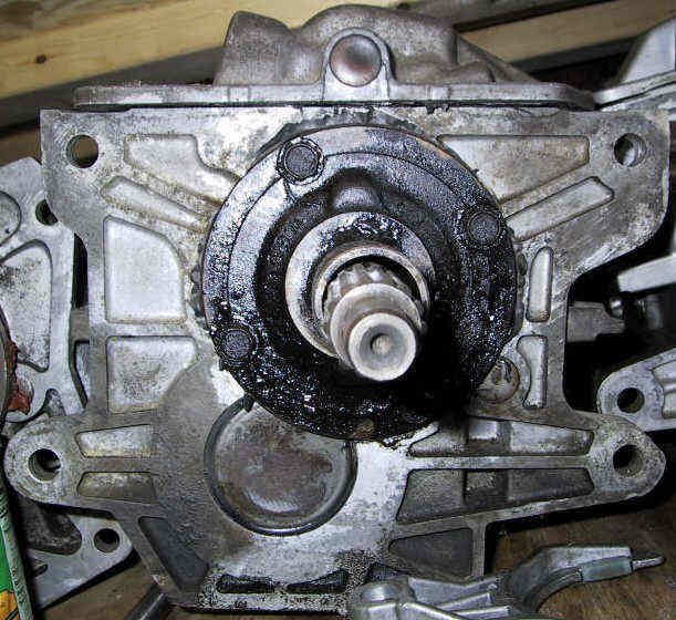

Yeah the only thing that's different at all on the face of the older trannys is the countergear bearing cap, which doesn't interfere with anything. The bolt pattern, bearing retainer diameter, input shaft spline count, and mounting angle are all the same on the older and newer ones. The only time any of that changes is if it's a V6 trans instead of a V8 one.

Ok thanks thats good to know. I know what you mean about the countershaft bearing race being different, because the non wc has flat rollerbearings where as the wc countershaft rides on tapered rollerbearings and has a cast shell. but what i meant was the structure of the front face. the general shape of it, the top pic is an 83 non wc the bottom pic is a 85 wc. thats all that was confusing me lol

Oh ok, I gotcha now. Yeah, looking at the pics I see what you mean about them looking a bit different, but as far as the bolt hole spacing and such, it's the same on both. In fact, even the V6 ones have the same bolt pattern, but they have a 14 spline input shaft instead of 26 spline, and the V6 input shaft is about 1/2 inch longer. Lots of guys have gotten a special clutch disc that's 14 spine-10.5 diameter, and cut off that extra 1/2 inch on the input and used the V6 trans behind a V8 motor. Not recommended though because the V6 T5's have different ratios that are pretty lousy when mated up with a V8!
