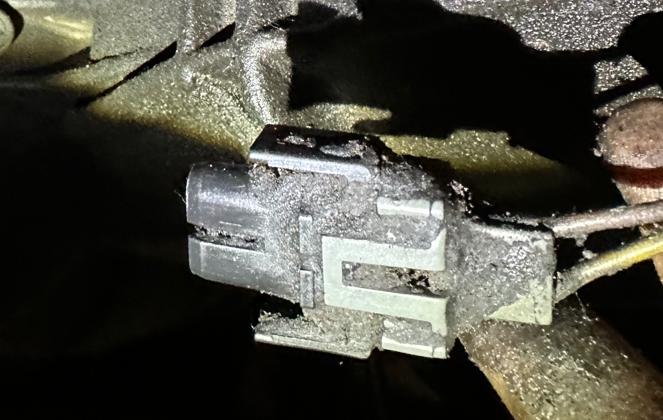

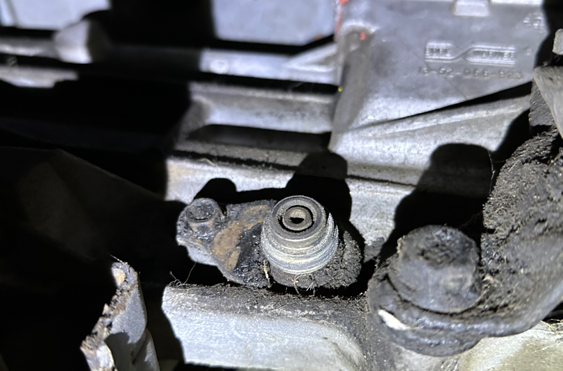

I did a swap from automatic to a T5 5 speed and I am trying to get my speedometer working.
Currently on the T5 I have a mechanical sending unit:
And the stock wiring from the car came with this connector:
I've seen some other threads that say you can just slap one of these in there and hook it up: Part #: 10456087
But before buying I just wanted to confirm this will work.
Are there any other options?
Will this fix my odometer as well?
Thanks for the help!
My Car: 1990 Camaro IROC-Z 5.0
Transmission out of a 1992 Camaro RS

Why does the 92 transmission have a mechanical cable speedo drive in it? All Camaros were electronic speedo in 1990+. (Firebirds changed in 1986).
You need to find an electronic speedo from a 90-92 T5 transmission. (86-89 is different signal). And the plastic gears inside the trans and the sensor need to match your rear end ratio.
I don't know about your odometer. That's driven by the speedometer itself.

Maybe I was give the wrong info about the T5. If it is an older transmission from 86-89, what can I do to get the speedometer working?
See this reply.
And good luck, because they're discontinued and hard to find.
