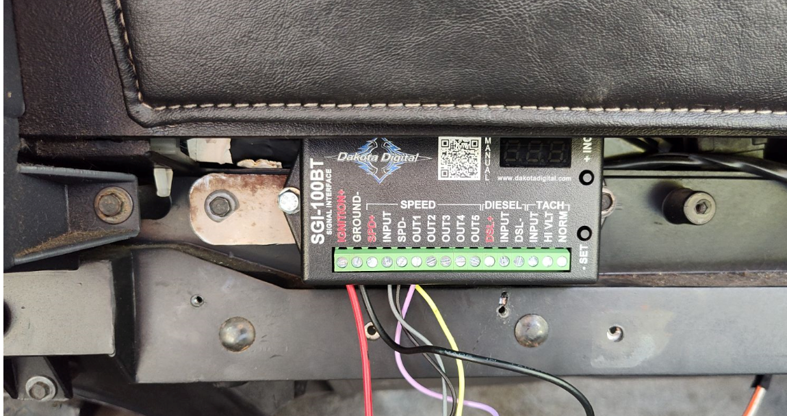

Got this project done. We ended up installing a mechanical setup for 3.73 gears blue and red gears then we used the dakota digital SEN-01-1
https://www.dakotadigital.com/index....rod/prd620.htm
To calibrate to the factory signal we used the SGI-100BT: Universal Speedometer Interface box. We used a calibration of 0.5 that makes sense bringing a 8kppm to 4kppm.
https://www.dakotadigital.com/index....od/prd1192.htm
Install was easy wire new sensor into input of box, factory sensor lines into output of box then power and ground. After that use the Bluetooth interface and app on the phone to calibrate. I mounted the box under the map pocket
