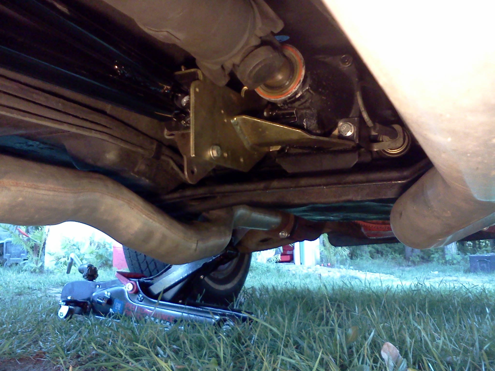

Hopefully these can help those wondering what it looks like after install. The bushing in these pics have a modified energy suspension bushing (had to do some cutting on the bushing with a band saw to make it fit this bracket). It came with the edelbrock torque arm that is in the pics.
NOTE: The outer bracket that holds the bushing and torque arm to the B&M bracket is the one that was originally on your car. you re-use it(for the guy who has no instructions)

Here is the old bushing I had on the b&m bracket when i had the stock torque arm in. The bigger one is a little bent cause i had to grind off the rivets and pry it off so i could put the energy suspension bushing in.

hey looks like i guessed close to right go me lol thanks very much wish i had these before would of been a very big help
