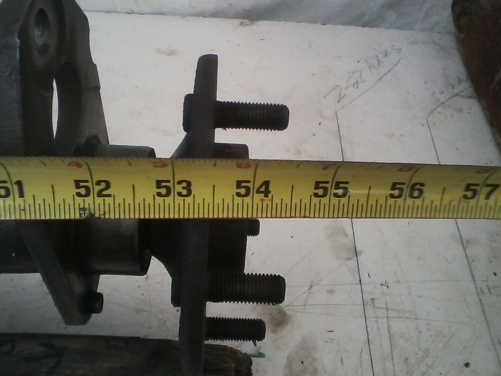

Hi I was doing a project Buick Skyhawk and started looking into this rearend. Well all the ZR2's do come with the 8.5 but is 63 inches long compared to the stock size. The 94 and up LT35 with a 5 speed manual also had the 8.5 but it was more narrow at 54.5 to 55, this what I seen. I think the ZR2 is great if someone is running wide tires where you can run deep dish rims, use caution because i still believe them axel tubes will need to be shorten. And the last topic its leaf springs not coil, so you'll have to have a Professional weld that in at the right degrees

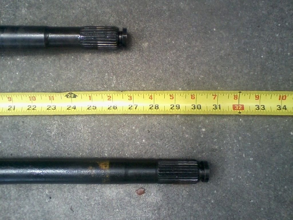

I may keep my eyes open for a ZR2, 8.5". I did use 2wd, S-10 axles and narrowed my 7.5". Might help figure out width? But nothing is going to beat measuring one in person.

Quote: I may keep my eyes open for a ZR2, 8.5". I did use 2wd, S-10 axles and narrowed my 7.5". Might help figure out width? But nothing is going to beat measuring one in person.
you've got that right about one person doing the measurement, some people forget but your right, if it's you, you will remember the numbers. I'm glad you post a picture. Alot of these guys cant measure and just say it's this. I heard it was 54.5 to 55, but your tape measurement shows different lol. For sure I heard but you might have to measure it lol. But the ZR2 was 63. So double check that one. So the 1994 and up had the LT35 and was a Standard was 8.5 for sure. I guess it's the budget you want to spend? I've seen a 1961 Pontiac Catalina with 9.3 it was really heavy duty, but try and looking for parts? Guy was on Ebay selling a 3:73 for $2,500, no housing or axels, for this price I could get a Dana 60 or the 12 Bolt with the torque arm. I was going to use a Chevelle rearend, but you cant find the crossmember that the upper arms bolt to. Had a guy for $800.00 could weld and make up a crossmember in 2 days for me. I seen some ladder bars on Ebay and $100.00 for them, $75.00 for the crossmember for them and call it a day..As long as you have a upper control arm set up your ok. They do have the Triagulated 4 link set up that welds into your frame. So there is ways and placing in certain rearends into these F Body cars. I also seen the 1976 Chrysler New Yorker rearend, 9.25 for $250 on ebay. But once again, alot of these rearends need to be chopped. Have a good day buddy.
