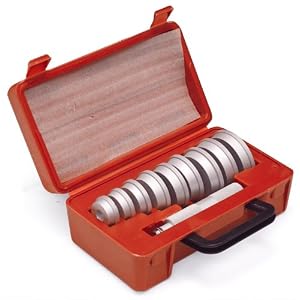

Old Jan 21, 2013 | 08:50 AM
TTOP350's Avatar
Posts: 12,232
Likes: 1,166
From: Il
Engine: 4++,350 & 305 CIs
Re: 9 bolt wheel bearing race removal?
This what I use
Old Jan 21, 2013 | 11:20 AM
big gear head's Avatar
Joined: Sep 2008
Posts: 3,777
Yea, that's what I use too, but they never seem to start straight. I always have to use the steel bar to move them around until they go in straight.
