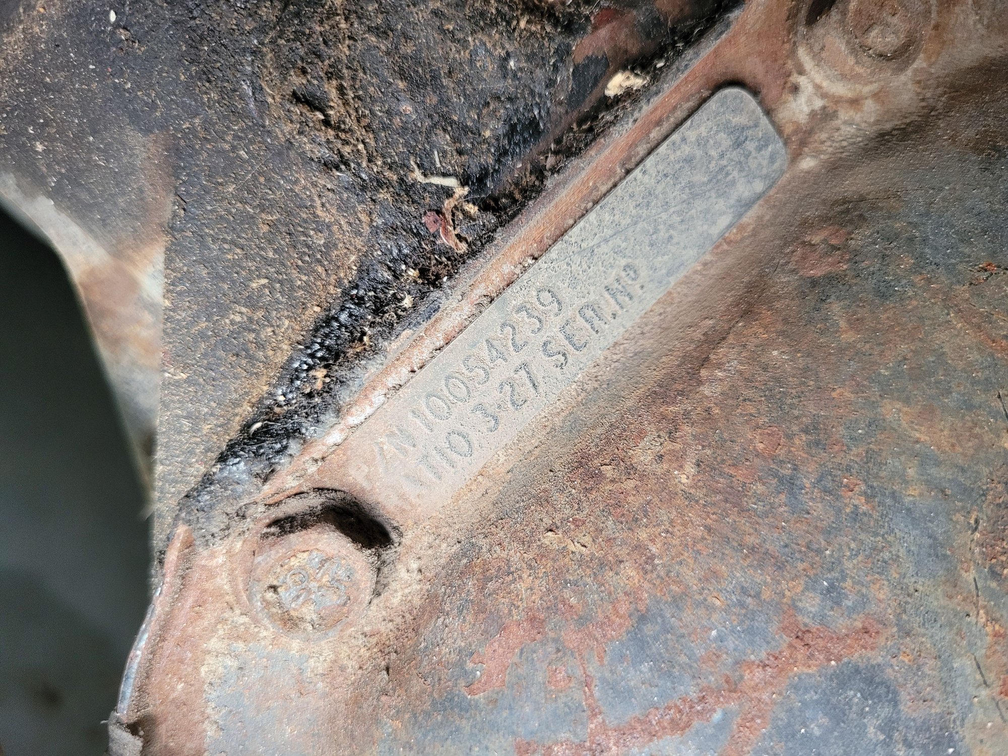

Old May 26, 2022 | 11:21 AM
Bishopts's Avatar
Joined: May 2022
Posts: 191
Likes: 19
From: South dallas
Car: 1988 gta
Engine: 5.7
Axle/Gears: 3.27 posi with discs
Re: Rear - end size?
Originally Posted by midias
Pull the cover and look inside the rear
I haven't taken the cover off. But this tag is on it. 3.27 gears with disc brakes. It has a fill plug on the right side of the cover looks kind of like the differential on my wj grand cherokee I used to have.
Old May 27, 2022 | 11:30 AM
Posts: 27,996
Likes: 2,485
how would you know if you have a g92 rear end option?
Problem of course is, "G92" isn't "a gear ratio" on its own, or anything fixed, like that. It means "upgraded gear ratio". Obviously the exact meaning of "upgraded" has 2 components: what the "standard" one was, and what the "upgraded" one is.
In some years/models of the 9-bolt, the "standard" was 2.77, and G92 got you a 3.27. In others, "standard" was 3.08 or 3.27, and G92 got you a 3.45 or 3.70. So a 3.27 could be either, depending on the other details of the car. (engine & trans)
G92 also usually came with the dual cat setup, at least in some years. That gives you a possible way to tell. If your car has that, it probably came with G92, but by no means certain; if it doesn't, who knows, as it could have been changed out at some point.
But all that aside, what difference does it make if the car came with G92 or not? What REALLY matters is THE PARTS it's built out of NOW (which might not be the same as it came with anyway); such as, the gear ratio. If you want to know what the gear ratio is, far better to proceed directly to determining the gear ratio, rather than worrying about RPO codes.
Personally if it was THAT important TO ME, I'd just make a point of changing out the fluid, since it needs that done anyway; and accidentally count the teeth while I had it open. I can take one look at the rear in the photo and see that it needs new fluid, in any case. Just like they all do if YOU haven't done it. Not much point in posting on the Interwebz about something you can find out yourself by catching up on the deferred maintenance the car needs.
