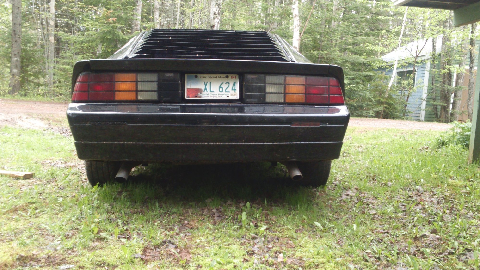

Post a pic of the car, and of the place on the rear bumper with the "HO" badging, and someone here who is familiar in detail with these cars might be able to tell you what parts it's built up out of.

Re: 1987 z28 305 ho What will fit?
Well the guy I bought the car from knew nothing about it himself he bought it as a project and then needed shoulder surgery so sold it two weeks later. I bought it because I was looking at another camaro and figured this would make a good parts car I didn't even expect it to run as it was parked for 3 years so that was A bonus in itself. I only paid 450$ so now the only stuff I know about the car is the random info I got looking around the car and what you guys are telling me
Pretty typical... the guy stuck ONE HO emblem on it. Out of the 4 that belong.
Looks cool, eh? meaningless; but, cool?
Not sure what that is in the turn signal light holes either.
But hey, for $450, that looks, from here at least, like an OK car. I've seen AHELLUVALOT worse for AHELLUVALOT more.
Ya the guy who last drove in was a bit if an idiot from what I hear and he painted chevy signs in the signal light holes. Looks dumb imo. He was asking 3500$ for it a couple of years ago
