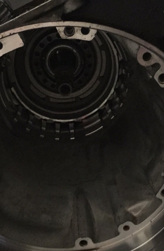

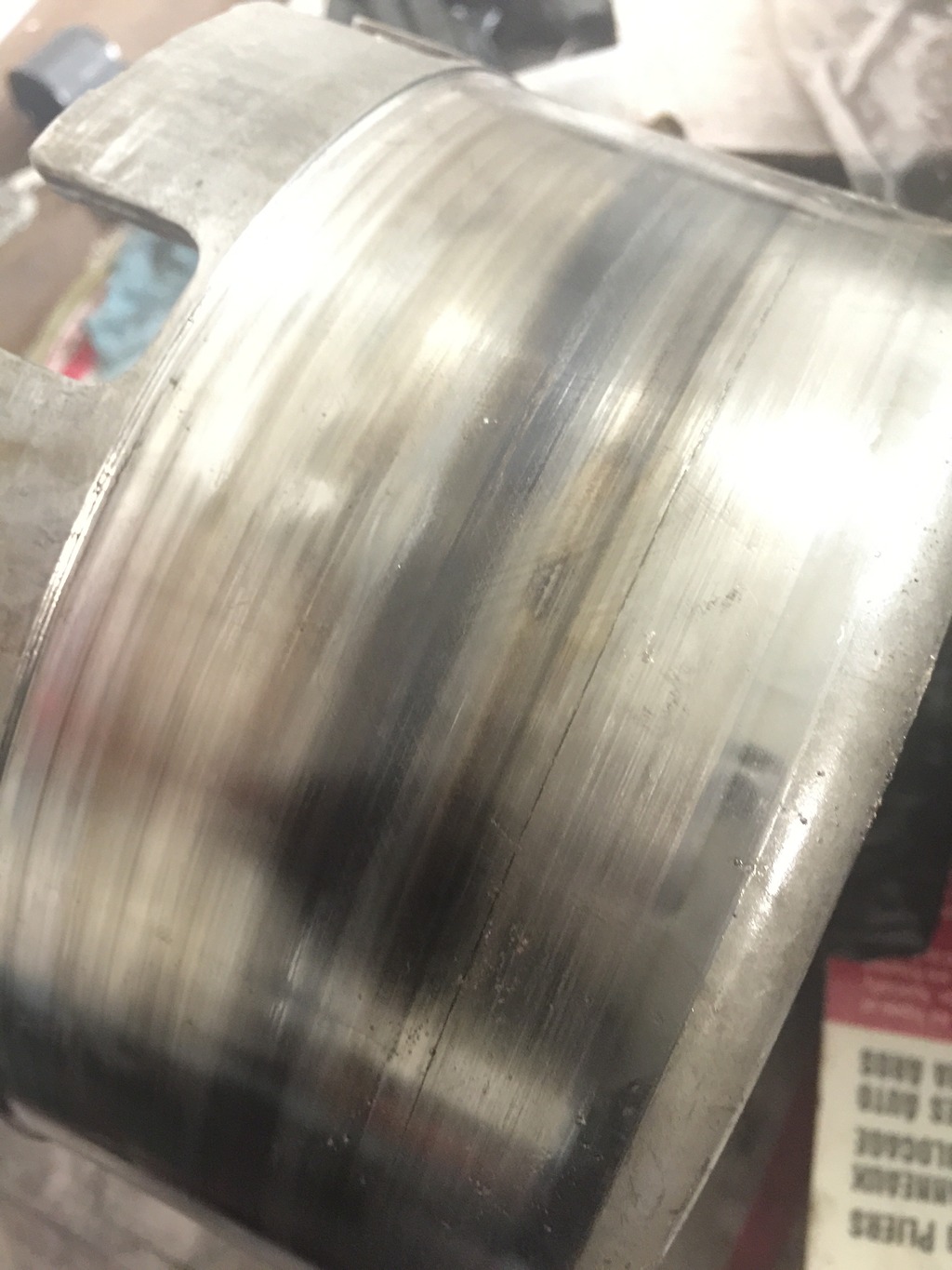

Forgot to post pics lol
2-4 band gone
3/4 burnt and gone also
Tossed in all new clutches and Borg Warner 2-4 and 3-4
Beast sun shell etc etc
Replaced all hard parts as I had spares of everything most was good tho besides drum but swap them out anyways
Tossed in slotted steels in supposedly good for 5% increase in fuel economy and more efficient that I read somewhere awhile back
Supposedly trans only had 5000 miles and supposedly built by a reputable trans builder then got blown then rebuilt again by we'll know tpi guy not saying no names but anyways
But this trans just looked like and regular stock rebuild with stock parts
So installed shift kit and stiffer accumulater springs along with .500 boost valve and .293 reverse and stiffer spring along with that
I'm sure I'm forgetting other things I did but I can sure say it's a mildly built trans now
Only good thing was it did had a 29 dual cage sprag but I had spare one laying around along with a box full of othe auto stuff
which leads me to believe trans was just stock rebuild and sprag went to crap and they replaced it with a dual cage and left everything else as is smh why half *** work smh
