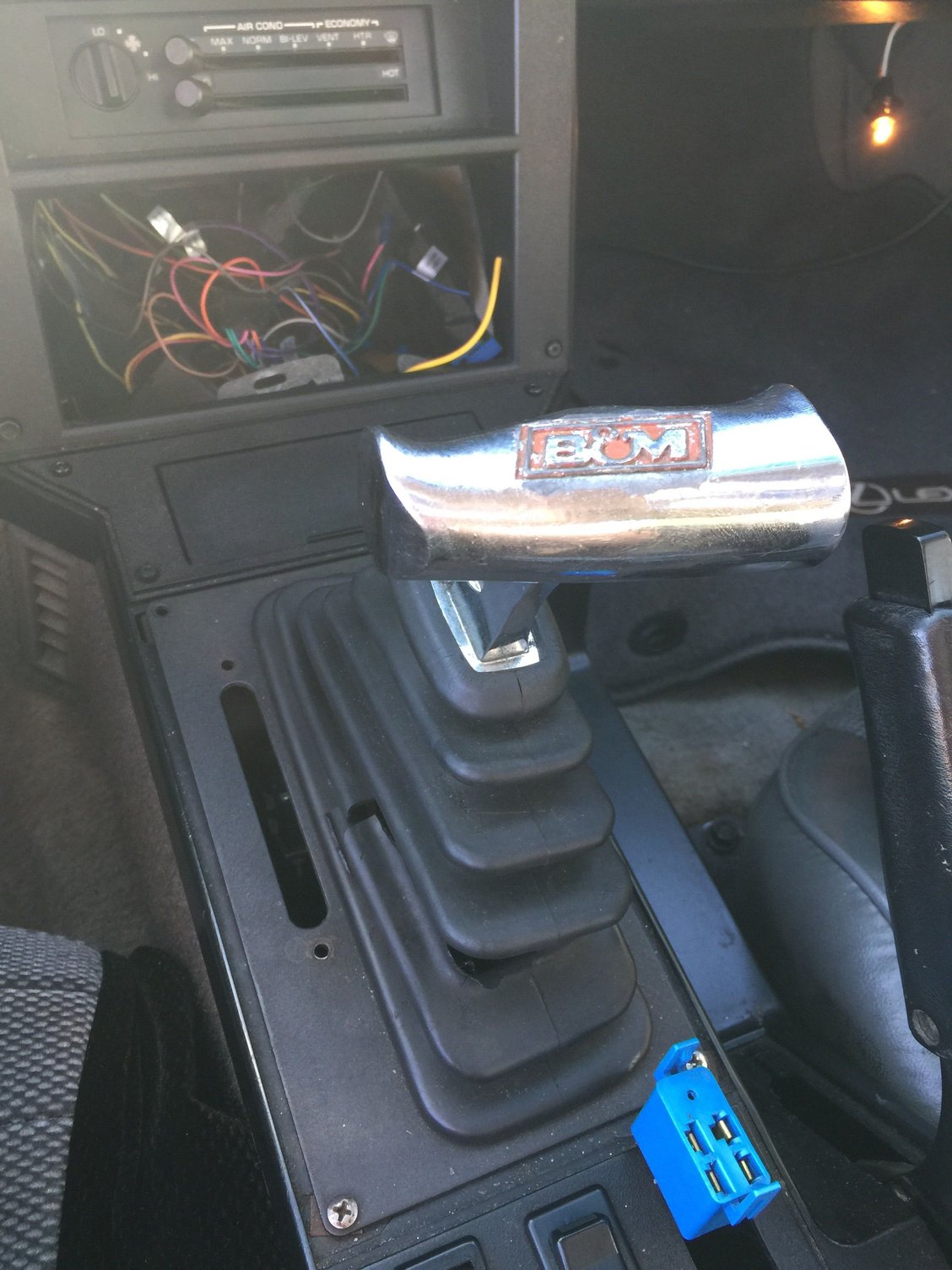

How to I change out this B&M
Sorry, don't know a lot about cars. Just bought a 1989 IROC and it had this in it. I want to swap it out and out the original back in. Right now the car only goes into Neutral, reverse, and drive. Help please?!???

If the person used the console fit direct bolt in B&M shifter then you should be able to un bolt it and bolt in a stock shifter and install stock shift cable.
Try adjusting your shift cable though on your B&M shifter, under car at the transmission. Download the owners manual from B&M and adjust it going by the manual. Mis adjusted cable is the #1 cause of that sort of probs with the B&M shifters
I have a stock shifter, cable and shift plate (top part of console around the shifter, and ask tray) from a 1984 z28 for sale if you need a stock one
