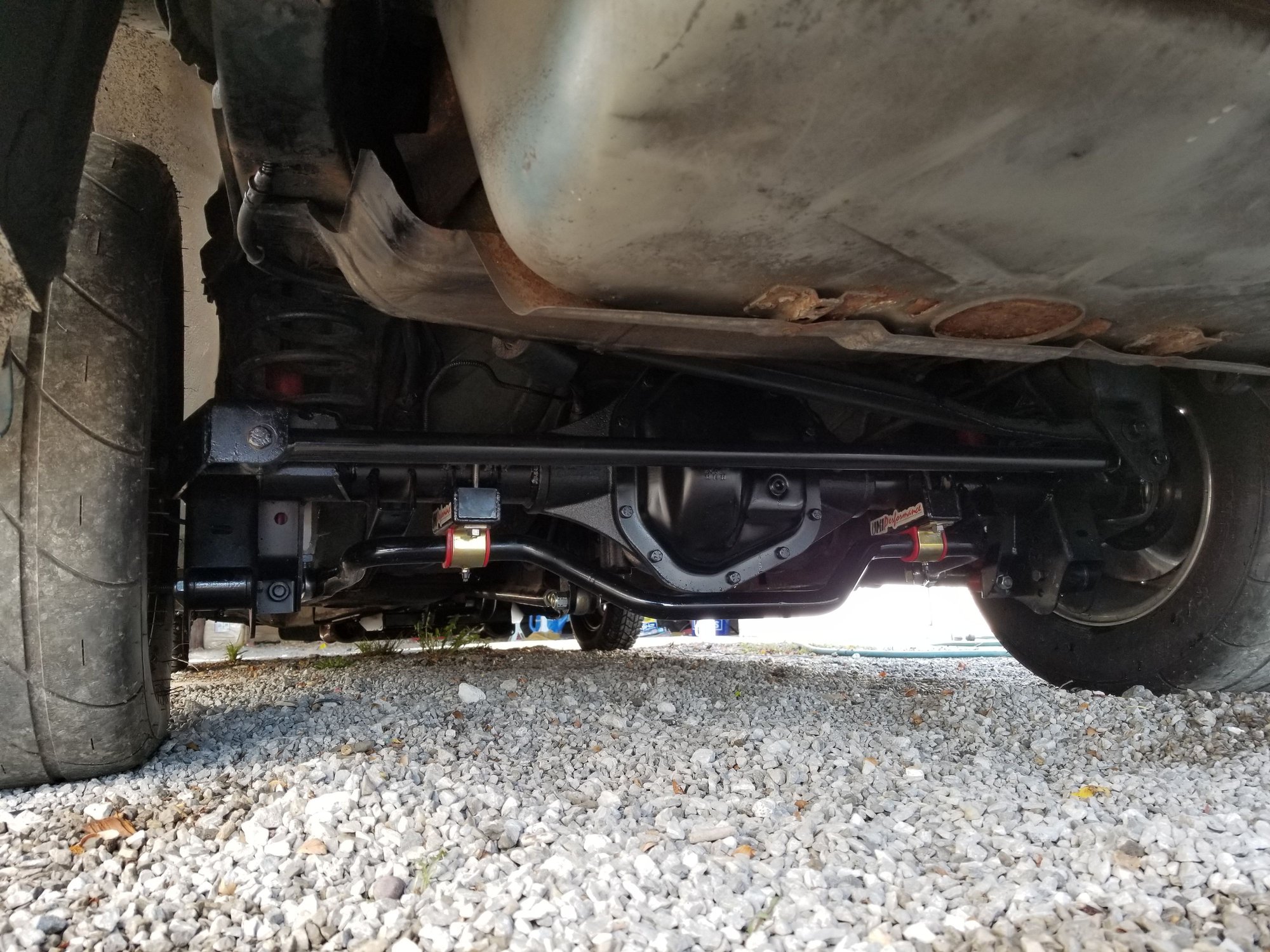

I have the race style s60 strange rear. 4.10 gears. It's heavier but with gun drilled axles, spool, it's not really that bad. Got it from Midwest Chassis and it was delivered in about 3 weeks from the day of ordering it.
Was the best priced option for me and i love it. It will never break.9.75 inch ring gear... 35 spline axles. It will handle your hp needs and then some.
Roughly 2800 bucks delivered, assembled, with strange disc brake kit included.
