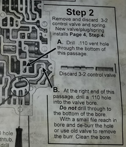

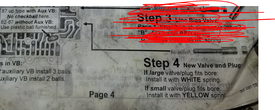

I've posted excerpts of the instructions here. Transgo has you remove and 'discard' the original 3-2 valve parts (I still have them), then there are 2 holes drilled in that passage and a new valve, spring and plug are installed.
I notice that the spring is in a different location after the Transgo valve goes in, is that right?
