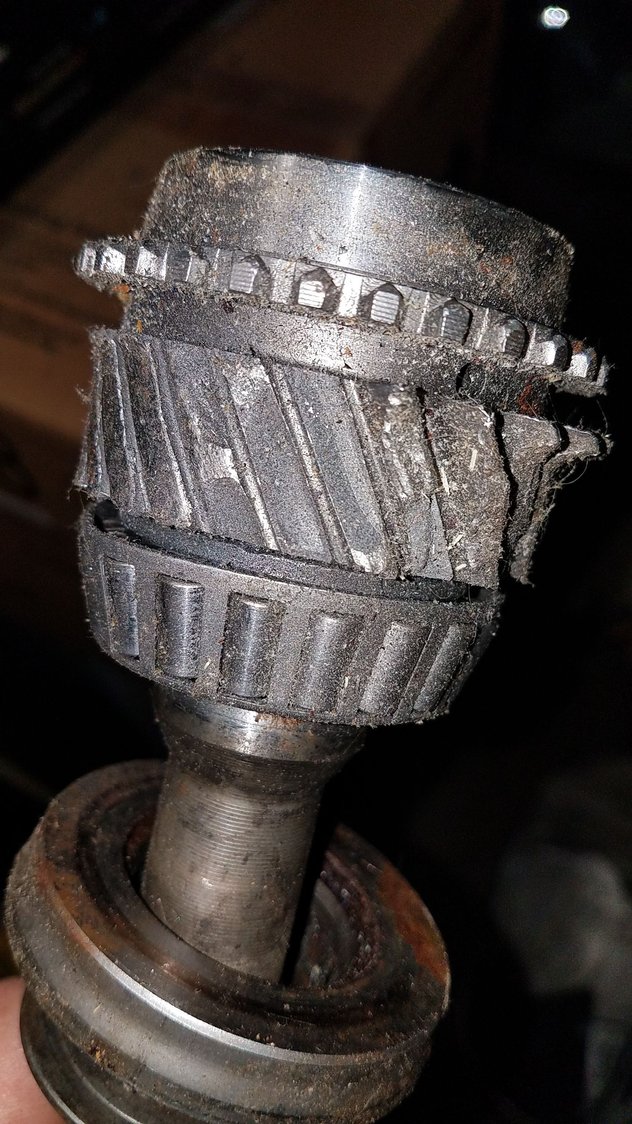

I don't have experience with G-Force, but also killed the non World Class T-5 I had in my 85 Trans Am twice before swapping in a T-56 I still have the input shaft with a bunch of teeth sheered off for a clutch alignment tool.
