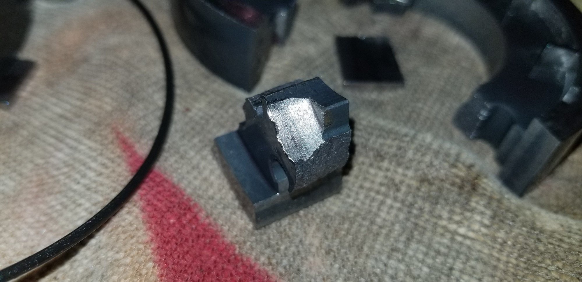

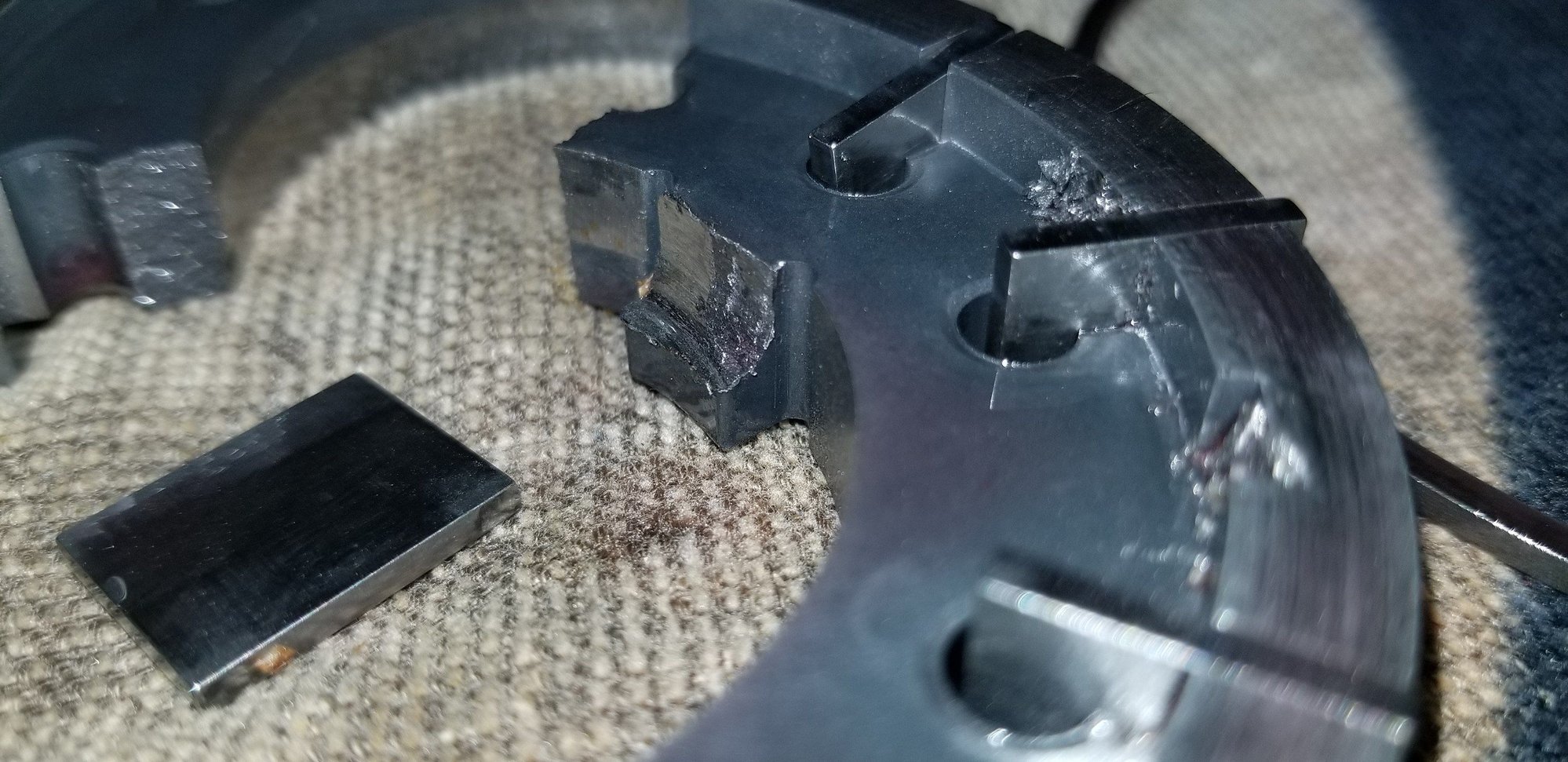

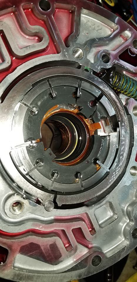

Old May 2, 2018 | 05:59 AM
FART_NUGGETS's Avatar
Joined: Oct 2017
Posts: 199
From: Southern NJ
Car: 1989 Iroc-Z Convertible
Axle/Gears: 2.73:1
Re: 89 700R4 lost all gears on highway
Pump is toast. Apparently there was too much of a gap between the reman converter and the flex plate, which caused the converter drive to not fully engage the pump ears when I bolted it to the flexplate. I should have shimmed with washers. Haven't removed the pump yet but I can see in the gap between the input shaft and seal that its chewed up, one ear appears to be missing. Hopefully pull the pump tonight and open it up.

Good times. Grabbed a reman pump for $90, going to replace the converter too just because I'm paranoid and it's cheap.
Old May 2, 2018 | 07:35 PM
Joined: Oct 2017
Posts: 199
From: Southern NJ
Axle/Gears: 2.73:1
I even cracked the slide ring so I do feel kinda special
