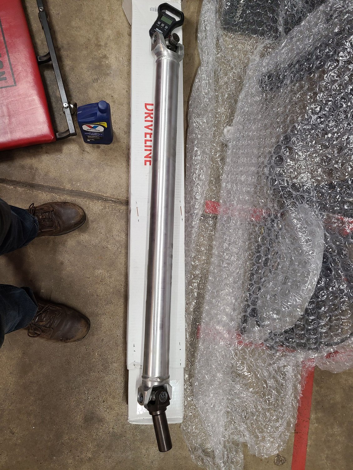

I ended up calling Inland Empire to discuss their drive shafts. They confirmed that they use maintenance free joints, instead of the greaseable type. He explained that the greaseable ones are nice since they can be re greased, but they usually are made to looser tolerances and after running a short while some of the grease slings out and leaves the fit somewhat loose. The maintenance free ones instead are sealed with all the grease they'll ever need trapped inside. They're also machined to tighter tolerances with better surface finishes on internal components, so in the end they are usually considered the better options for performance use like ours. The Summit shaft has a seal front but greaseable rear, I believe...

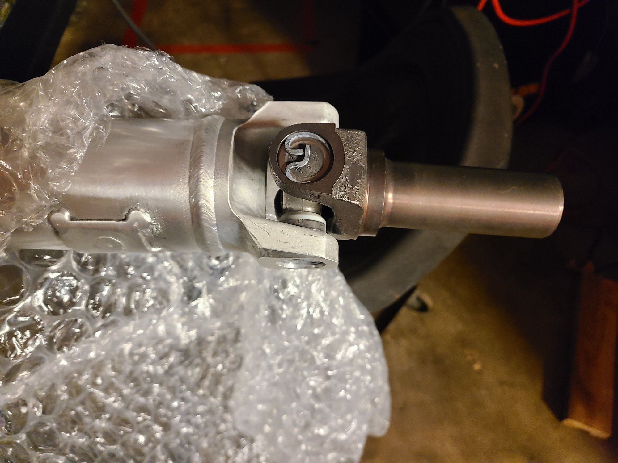

I also noticed some inconsistency in the finish of the front transmission yoke. In some photos it was black oxide treated, and in others it appeared raw steel. Turns out they do black oxide most of their transmission yokes, but in the case they have a lot of orders that will be shipping quickly, they sometimes skip the step. He said it was more of a preservation for while they sit on their shelf, not for operation, but he said if I wanted, I could specially request to make sure I got a black oxide one, for no additional charge.
In the end I ended up ordering the shaft from Inland Empire with the black oxide treated transmission yoke. I've received it and installed, it yet I'm still completing my custom fab front drive shaft loop, so not miles on it yet... Looks like a very nice part. It is also moderately lighter than the steel 2.5" stocker which weighed 15.98 lbs. The new Inland Empire 3" aluminum shaft weighs 10.84 lbs!
