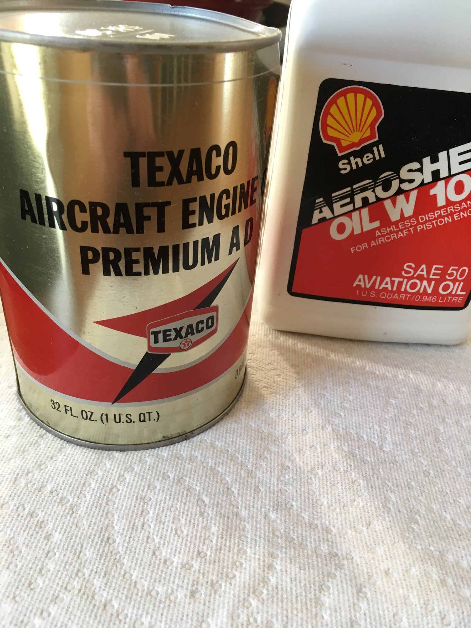

LOL. Why don't they just go to the aircraft supply and buy some of that 70 weight oil that was used in the old radial piston engines.

Old May 6, 2019 | 01:40 PM
OrangeBird's Avatar
Joined: Feb 2012
Posts: 3,939
Likes: 801
Car: 1989 Firebird
Re: Replacing ATF Firebird V6 3.1, amount of fluid?
I still have some kicking around from before I retired
Timothayyy
